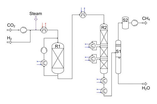

For the methanation process and plant design, different plant capacities (1,000 and 10,000 m&sup3;/h CH4) and feedstock mixtures (pure CO2 and a mixture of 50% CO2 and 50% CH4) are being considered. The dynamic operation of the plant is being tested with a part load from 30% to 100%. The plant uses a staged fixed-bed catalyst reactor, which is an in-house development based on knowledge obtained from sulfuric acid production plants.
Similar to SO2 oxidation as an interim step for sulfuric acid production, the methanation reaction also involves gaseous reactants and products:
4 H2 + CO2 D CH4 + 2 H2O ΔHr = −165 kJ/mol
Further similarities include the temperature range and the release of significant amounts of heat due to exothermic reactions. The heat of the methanation reaction leads to an increase of the gas temperature in the catalyst layer. On a large production scale, the reactor can be considered adiabatic. The conversion of CO2 is limited in accordance to the temperature equilibrium curve. To obtain the maximum CO2 conversion efficiency, the methanation is performed in several reactor stages where the gas is cooled before entering the next stage. Unlike the common sulfuric acid process, the methanation is designed to operate at elevated pressure (20 bar) to increase the yield of CH4.
Process calculations for 10,000 m&sup3;/h product gas (methane) with Aspen Plus and plant design were made (Figure 2). To achieve a high yield of methane, the process has four reaction stages arranged in series with gas intercoolers. The first step of the reaction takes place in the single fixed bed reactor (R1 in Figure 2). Stages 2 to 4 are included in reactor R2, which is the so-called stage reactor (reactor from sulfuric acid production).
2. Process flow sheet for the 10 000 m&sup3;/h methanation design, with energy integration. Courtesy: Outotec
Hydrogen and steam are supplied from electrolysis with a pressure of 20 bar. The CO2 stream is pressurized to system pressure by a four-stage compressor and fed to the reactor R1 via a heat exchanger. From the reactor R1 outlet, a part of the product is fed back to the inlet in order to control the heat of reaction. The gas is fed to reactor R2 after cooling it to 300C. After each stage in reactor R2, the gas is cooled to the same temperature of 300C before entering the next stage. The byproduct water is removed in two stages, flash and molecular sieve (S1 and S2, respectively, in Figure 2).
An energy integration by means of a pinch analysis was performed for this process. Before energy integration almost 60 MW of process heat was available. After the energy integration more than 30 MW of process heat is used directly for heating up the feed gas to the reactor R1 and for producing electricity via a steam turbine. This electricity is used for the operation of compressors and other consumers. However, 27 MW of process heat are still available for further use (such as steam production or district heating).

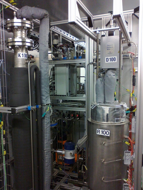

At the Outotec research center in Frankfurt, a catalyst test plant was commissioned to study the catalytic methanation of carbon dioxide and hydrogen (Figure 3). The capacity of this unit is 4 m&sup3;/h of gas flow (inlet), the operating pressure is 20 bar, and the inlet gas temperature is a maximum of 300C. Different fixed bed catalysts (these are commercially available for the methanation of carbon monoxide) will be tested for the methanation of CO2. The goal of these tests is to optimize the operating window of the commercial plant and to select the ideal catalyst for producing CH 4 from CO2.
3. The catalyst test plant is shown here. Courtesy: Outotec

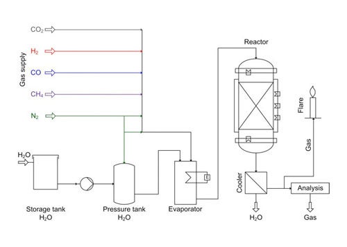

The process scheme is pictured in Figure 4. A mixture of feed gas is fed to the evaporator from gas cylinders. In the evaporator the feed gas is enriched with steam. Afterwards, the wetted gas is fed to the fixed bed reactor, where the catalyst is placed in a single layer between inert material layers for uniform gas distribution. The reactor is heated to minimize heat losses to achieve quasi-adiabatic conditions.
4. Process scheme of the catalyst test plant. Courtesy: Outotec
The produced gas is cooled to separate water from the gas. Afterwards, the gas is analyzed for its composition of CH4, H2, CO 2, and CO using an online analysis device and burned in a flare.
Several experiments were performed with one commercial catalyst for CO methanation at different inlet and maximum temperatures in the catalyst layer, as well as different gas hourly space velocity. The maximum temperature in the catalyst layer was controlled by adjusting the CH4 content in the reactor inlet gas stream. The catalyst height in the reactor, stoichiometric molar ratio between H2 and CO2 (H2 / CO 2 = 4) and addition of steam to prevent carbonizing of the catalyst (30% vol.) were constant. At these conditions a conversion of CO2 up to 70% was achieved.
