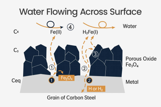

Other components, including feedwater piping, cross-under piping, and turbine steam systems, also face deterioration. One common issue is flow-accelerated corrosion (FAC), where flowing water or wet steam gradually wears away the protective oxide layer inside carbon-steel pipes, leading to wall thinning (Figure 1). Damage can be particularly severe around bends, joints, and areas where flow changes direction or speed. Vibration, water droplets, and temperature changes can cause further wear. Because deterioration often occurs internally, it may not be visible during routine external inspections.
1. Flow-accelerated corrosion diagram. Courtesy: IGS

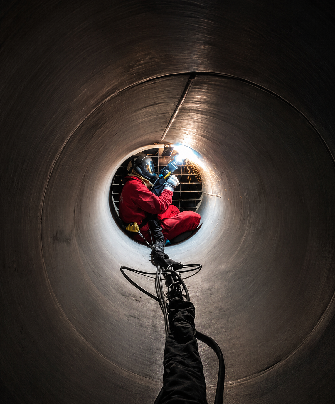

Unlike weld overlay, HVTS application (Figure 2) does not create a heat-affected zone in the base metal and can be completed more rapidly by eliminating post-application heat treatment requirements. Shorter application times may help operators complete maintenance work within planned outages and, where radiological controls apply, support ALARA (as low as reasonably achievable) objectives by reducing time spent in exposed work areas. The potential exposure benefit must be assessed against the full work scope, including preparation, application, and inspection.
2. HVTS application. Courtesy: IGS

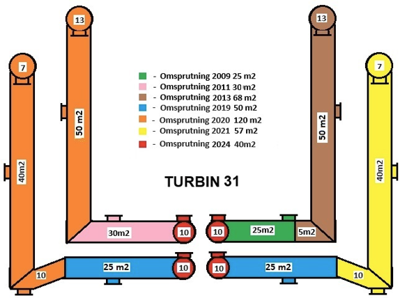

An application at one nuclear plant illustrates this approach. High-velocity wet steam had caused FAC and erosion in cross-under piping, particularly near turning vanes and high-flow regions. The operator sought to limit further wall loss without the disruption associated with large-scale piping replacement.
A localized HVTS trial began in 2009. In a wider life-extension assessment initiated in 2018, the plant evaluated pipe replacement, weld overlay, and HVTS cladding. Inspections identified priority locations (Figure 3), allowing the operator to divide surface protection work into planned outage scopes. Existing protection was removed where required, and engineered HVTS alloy cladding was applied to selected surfaces where the piping was suitable for continued service. This enabled the operator to focus on vulnerable regions rather than treat all piping identically, while coordinating preparation, application, and inspection with other outage activities.
3. Application areas and phased scope. Courtesy: IGS
The project involved approximately 8,000 ft2 (740 m2) of treatment per unit across two units, delivered through a phased four-year program. Annual application areas ranged from approximately 850 ft2 to 3,000 ft2 (79 m2 to 279 m2), with no additional outage days required. Long-term performance has also been demonstrated, with cladding applied during an initial trial in 2009 reported to be in excellent condition after more than 15 years of service.
