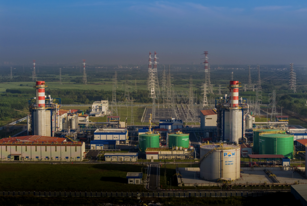

Vietnamese media have reported that the country has more than 20 LNG-fueled power plants in development and design stages, including the two units at Nhon Trach, which are sited in Ong Keo Industrial Park in the Nhon Trach district, about 45 miles southeast of Ho Chi Minh City. The new units join the existing Nhon Trach 1 and Nhon Trach 2 power plants, which together have 1.2 GW of generation capacity.
Nhon Trach 1 came online in August 2009. The plant is equipped with two GE-supplied GT13E2 gas turbines capable of running on fuel gas and fuel oil. Nhon Trach 2, which was commissioned in October 2011, features two Siemens-manufactured SGT5-4000F gas turbines.
