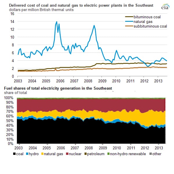

For the southeast, part of the cause is the distance from coal-producing areas. As crude oil price have risen, pulling diesel prices with them, the delivered cost of coal in the region has steadily climbed. Combined with the fall in gas prices, the cost advantage of coal has been largely erased (figure 1).
eia coal
1. The fall of coal. Since 2008, coal has lost nearly all of its cost advantages over natural gas in the Southeastern U.S. Source: EIA
