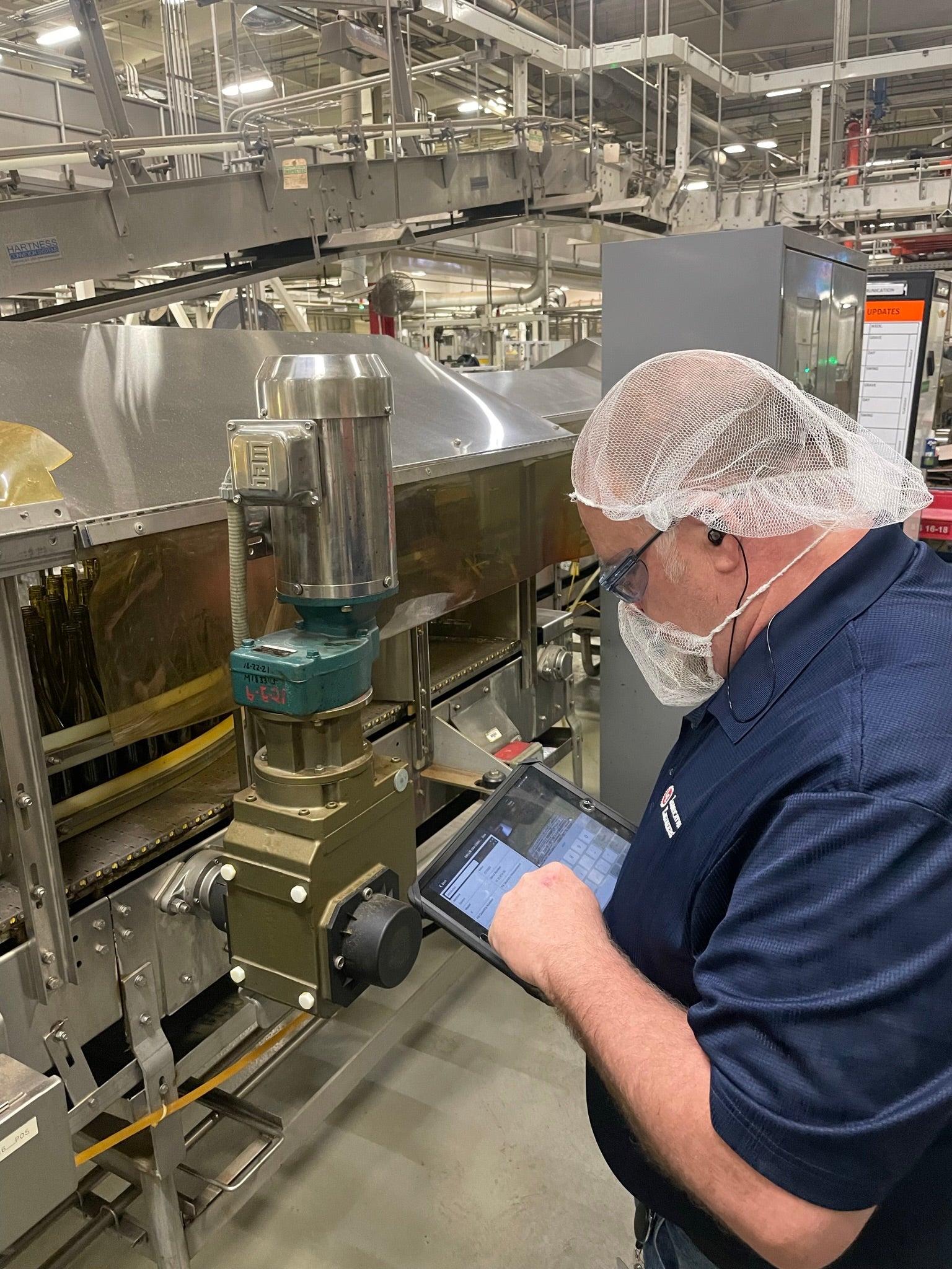

A Lubrication Engineers specialist conducts an on-site lubrication reliability test. Courtesy: Lubrication Engineers
By implementing an optimized lubrication reliability program, organizations can buy back time on multiple fronts. Automating fundamental tasks and deploying high-performance lubricants selected for the application can free skilled technicians to focus on proactive, high-value reliability initiatives.
This strategic reallocation of labor is just the beginning. The true ROI is amplified by extending component life and maximizing productive uptime. In one documented customer application, improved lubricant cleanliness was estimated to increase component life by at least 300%, helping turn maintenance from a cost center into a powerful driver of operational excellence.

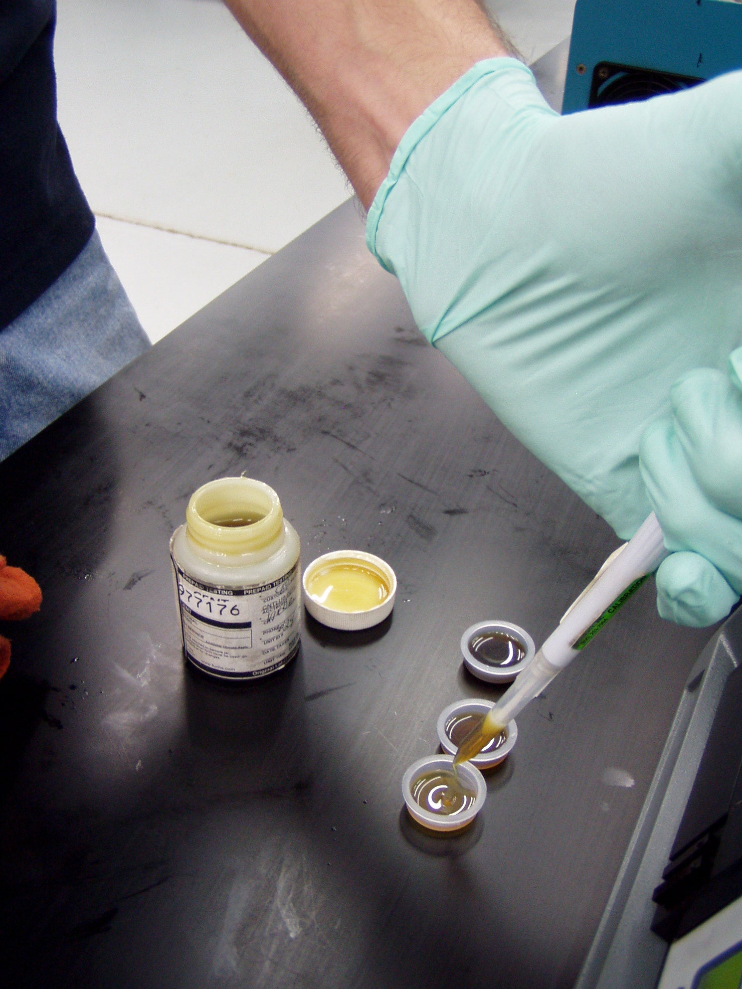

Oil Analysis: The Blood Work of Industrial Machinery
A world-class lubrication reliability strategy transitions an organization from a reactive maintenance environment to condition-based maintenance (CBM). At the core of this transition is oil analysis.
Think of oil analysis as diagnostic lab work for your machinery. Just as blood tests reveal underlying health issues in a patient long before physical symptoms appear, oil analysis provides valuable predictive insight into equipment and lubricant condition. It can identify contamination, lubricant degradation and certain wear conditions before they produce symptoms that are detectable through other condition-monitoring methods.
By sending oil samples to a laboratory for particle counting and ISO cleanliness coding, wear-metal analysis and viscosity testing, reliability engineers can identify several major threats to lubricant and equipment reliability, including:
  • Particle Contamination: Microscopic dirt and debris that cause abrasive wear on internal components.
  • Water Contamination: Moisture ingress that corrodes metal and destroys the load-carrying film of the oil.
  • Cross-Contamination: The accidental mixing of incompatible lubricants, which can alter viscosity, additive performance, filterability or other critical properties.
Controlling these sources of contamination can safely extend drain intervals, reduce lubricant consumption and improve asset availability.
Oil samples are being prepared for analysis, as part of the process to monitor for contamination, and to determine lubricant condition. Courtesy: Lubrication Engineers

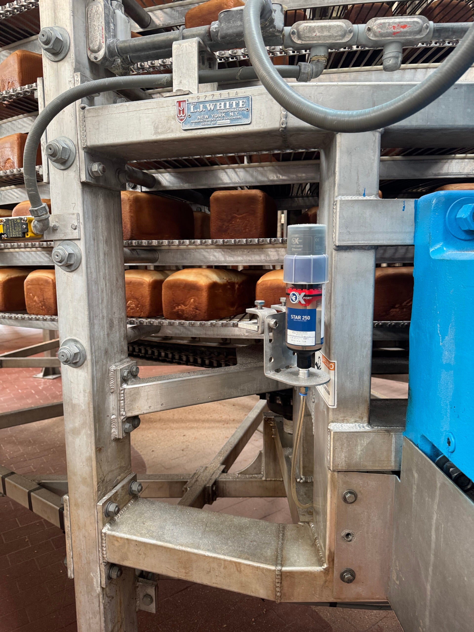

3. Deployment of Reliability Hardware: Best-in-class operations invest in modifications that protect the lubricant and simplify visual management:
  • Desiccant Breathers: Help control moisture and airborne particulates by reducing contamination before it enters the reservoir.
  • Oil Sight Glasses: These allow for at-a-glance visual monitoring of oil levels and condition, enabling rapid detection of cloudiness or water ingress without taking the equipment offline.
  • Automated Delivery Systems: Single- and multi-point automated lubricators provide consistent, precise application, reduce the risks of over- and under-lubrication, decrease repetitive manual tasks and limit maintenance personnel’s exposure to operating equipment.
4. Continuous Education and Standardization: A reliable program depends on proper training, consistent procedures and clear labeling. From storage and handling through final application, standardized practices help ensure that the program is executed consistently in the field.
Automated lubrication helps keep a high-volume food production line running reliably. Courtesy: Lubrication Engineers
