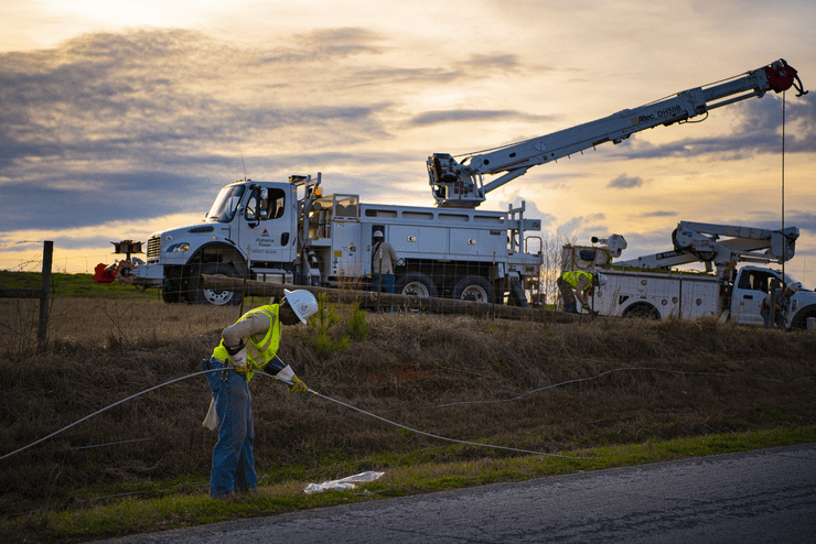

Considering the rural nature of our service territory, and with storm severity and frequency increasing, outages were creating reliability issues, which affected customer satisfaction. Because our crews must travel to each outage location to replace a blown fuse, these incidents also affected operations and maintenance (O&M) costs because of frequent truck rolls (Figure 1). To address these issues, we felt reevaluating our lateral-protection strategy could be valuable.
1. Alabama Power’s power delivery system includes more than 85,000 miles of power lines and more than 1.5 million poles and towers. Replacing thousands of traditional lateral fuses with S&C-supplied TripSaver II reclosers has prevented some temporary faults from becoming sustained outages, improving customer satisfaction and reducing O&M costs. Courtesy: Alabama Power
