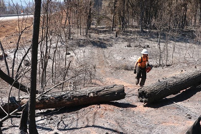

1. Utilities in areas prone to wildfires know they need disaster response plans, which include not only restoring power after an event, but planning how to reduce their risk from future incidents. Here utility workers survey damage from the 2018 Delta Fire in California. Courtesy: Baringa/U.S. Forest Service
Wildfires (Figure 1), exacerbated by climate change, are wreaking a heavy toll on the U.S. economy. According to a recent report by the U.S. Joint Economic Committee, wildfires cost the U.S. economy between $394 billion and $893 billion annually. Utilities on the West Coast are spending billions of dollars to mitigate wildfire risk. These wildfires often cause a level of damage that is higher than the market cap of the utility itself. In 2020, California suffered its largest wildfire season ever as 4.2 million acres burned across the state, resulting in more than $19 billion in economic losses and roughly $2 billion in firefighting costs.
