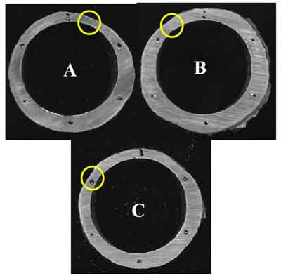

Ring samples (Figure 7) were sectioned from the tube for dimensional and hardness measurements (Table 2). Circles on the rings indicate thin spots. Significant wall thinning was observed, caused by fireside corrosion. The thinnest section of Ring A (0.120 inch at the 1:00 position) was at 41% of minimum wall thickness (MWT), Ring B (0.179 inch at the 11:00 position) was at 62% of MWT, and Ring C (0.145 inch at the 10:00 position) was at 50% of MWT. If the tube had thinned below 65% of MWT, the first choice should be tube replacement. Careful inspection via ultrasonic thickness measurement was recommended, with replacement of tubes less than 0.190-inch thickness. The hardness, averaging 78 Rockwell B (RB) was within the range for new tubing specification SA-213 T11, 76 to 85 RB, indicating that no overheating or metallurgical transformation had occurred.
7. Sectioned rings. Courtesy: David N. French Metallurgists

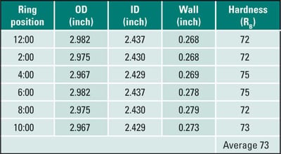

A ring sample (Figure 12) was sectioned from the tube for dimensional and hardness measurements (Table 3). The tube had not bulged. Taking the difference between the thickest and thinnest sections, the wall thinning was measured as 11 mils. This wall thinning is significant for waterwall tube about nine months old and is a wastage rate of about 15 mils/year. None of the measured wall thickness values was below MWT of 0.240 inch. The wall thinning resulted from the fireside corrosion on the OD. The hardness, averaging 73 RB is within the range for new SA-210 A1, 72 to 78 RB, indicating that no overheating or metallurgical transformation had occurred.

Table 3. Case 5 dimensional and hardness measurements. Source: David N. French Metallurgists
Elemental analysis was performed on deposit scraped from the OD surface. Table 4 shows that the deposit was primarily iron oxide. The presence of carbon within the ash deposits indicates that reducing conditions were present. The lead content was very high, and its melting point is 620F. This may be a significant factor in the tube wastage. The presence of chlorine content indicates the formation of the low-melting liquids that contained lead, zinc, and iron chlorides. Elemental results also suggest that K2S2O7 may have been involved in the fireside corrosion. K2S2O7 and Na2S2O7 are the primary susceptible compounds for fireside corrosion on waterwall tubes. The melting points of K2S2O7 and Na2S2O7 are 750F and 570F, respectively. Mixtures of these two compounds could melt at even lower temperature.

The tube suffered wall thinning resulting from fireside corrosion at a rate of 15 mils/year. This is a high rate of corrosion, though none of the measured wall thickness values was below the MWT of 0.240 inch. Reducing conditions in the furnace may have contributed to the OD corrosion. The formation of low-melting species on the tube OD may also have led to rapid corrosion. Chloride and sulfide species had dissolved the protective iron oxide, exposing bare steel to the corrosive environment, resulting in significant wall loss. Potassium pyrosulfate may have formed in the OD deposit and contributed to wall loss. The presence of lead and zinc may have further reduced the melting points of OD deposit. Typical carbon steel microstructure, with ferrite and pearlite, was observed without any degradation.
