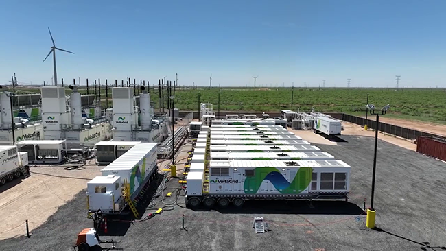

A similar shift is unfolding behind the meter (BTM). VoltaGrid has reported deploying large fleets of modular natural gas units (Figure 2) to support data center growth in Texas through partnerships with INNIO Jenbacher, Vantage Data Centers, and with hyperscalers like Oracle. Calibrant Energy and Aligned Data Centers recently completed an on-site battery system at a Pacific Northwest campus intended to accelerate interconnection. DEPCOM Power continues to build turnkey solar-plus-storage solutions for industrial customers, including BTM installations. Wärtsilä has likewise highlighted U.S. data center projects using its flexible engine platforms. Dozens of other companies are competing for fast-track natural gas turbine deployments.
2. VoltaGrid has established partnerships with INNIO Jenbacher for engine supply, Vantage Data Centers for project execution, and hyperscalers including Oracle to deploy modular, onsite gas generation fleets for data centers. Courtesy: VoltaGrid
