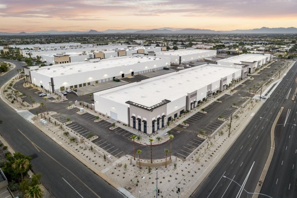

Amphenol Industrial manufactures utility-scale photovoltaic harnesses and other solar equipment, including at the company’s newly opened facility in Mesa, Arizona. Courtesy: Amphenol Industrial
