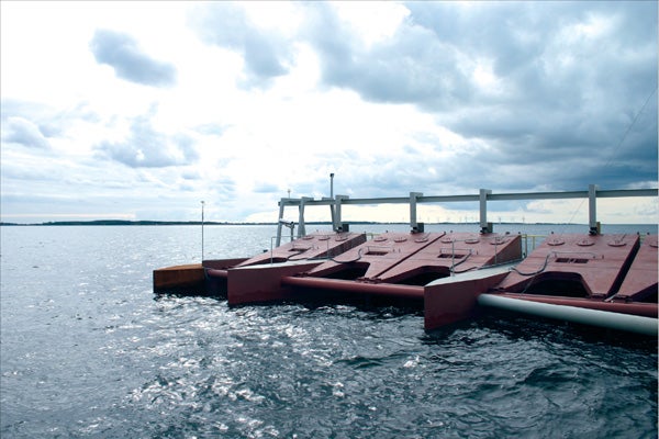

Meanwhile, Danish company Floating Power Plant this April introduced a novel approach to harness power offshore, which combines the best of wind and wave power. The company is in the process of completing a larger prototype of its Poseidon power plant in Lolland, Denmark—a 350-ton floating platform that will be outfitted with wind turbines.
The plant is based on a hydraulic power take-off system: The float absorbs inherent energy from waves and employs a piston pump (using water pressure to turn a turbine) to transform it into power. It also uses a patented anchor buoy system to ensure that waves always meet the front of the plant. The company says it plans to use three 1.5-MW or 2-MW “standard” offshore wind turbines—or possibly a single 5-MW turbine—to increase the amount of power generated from the seas. If it works out, the commercial version of the plant is expected to generate up to 50 GWh a year, depending on the waves and wind.
5. Flotsam and jetsam. Danish company Floating Power Plant has designed and is testing a 350–metric ton deep sea floating platform outfitted with 11-kW wind turbines to harness wave and wind power offshore. The company’s current demonstration platform at Nakskov Harbour will be followed by a commercial version, which the company says could generate some 50 GWh a year. Courtesy: Floating Power Plant
The current demonstration platform (Figure 5)—dubbed Poseidon 37—was launched at Nakskov Harbour, Denmark, in September 2008. Thirty-seven meters (m) wide, the entire platform is 25 m long and 6 m high. The devices that capture wave power beneath the surface are 6 m long and weigh 4.7 tons. This design follows three previous scale models, and in spring of 2010, it entered a high-profile second phase of testing at Onsevig that included cooperation from Danish research institutions. Once tests are completed next year, a massive, nearly 30,000–metric ton commercial version of the plant will be built.
