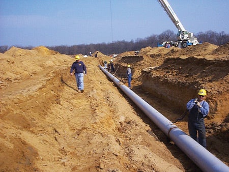

The threat is so significant that the OPS insists that pipeline operators take extensive steps to minimize it. Such steps include installing sophisticated corrosion-prevention systems (Figure 1), regularly maintaining and testing those systems, and reporting the results to regulators—a process the industry calls “pipeline integrity management.” An army of specialists, consultants, and service providers supports the pipeline companies in their efforts to mitigate corrosion.
1. Laying pipe. This segment of a natural gas pipeline is being installed to serve a power plant. Operators are required by law to protect their pipelines from corrosion that could compromise pipe integrity and lead to an explosion. But their responsibility for corrosion protection ends at the isolation flange, where the line enters the plant through a metering station. Courtesy: Matcor

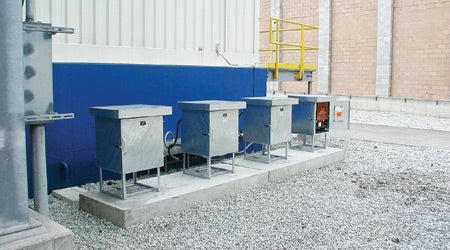

Pipeline companies’ corrosion-prevention measures take three forms: coating the pipeline during its construction, installing what’s known as a cathodic protection (CP) system to keep stray currents from fostering corrosion as the coating deteriorates, and regularly testing the integrity of the pipeline and the performance of the CP system. The tests include monthly inspections of the system’s key components—rectifiers (Figure 2), annual testing to ensure that the operating environment hasn’t changed, and intense surveying every seven to 10 years to validate the pipeline’s physical integrity. If any defects detected in the system are not reported to regulators and fixed promptly, the pipeline operator is fined.
 2. Rectifying the problem. The key components of a pipeline’s cathodic protection system are rectifiers like these. Courtesy: Matcor
