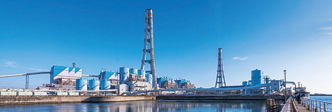

1. JERA’s Hekinan Thermal Power Plant in Hekinan City, Aichi Prefecture, is one of Japan’s largest coal-fired power plants. The plant’s Unit 4 in 2024 kicked off demonstration testing aimed at establishing technology to convert 20% of its fuel from coal to ammonia. Courtesy: JERA
If the demonstration testing is successful, JERA—a joint venture between Tokyo Electric Power Co. (TEPCO) and Chubu Electric—plans to commercially operate Hekinan 4 (Figure 1) with ammonia substituting 20% of its heating value. IHI, meanwhile, plans to apply its learnings from the testing demonstration to establish a technology for high-ratio combustion of 50% ammonia or more at thermal plants, as well as further its development of burners for 100% ammonia combustion. These advancements could be deployed at “other thermal power plants in Japan and overseas,” it said.
