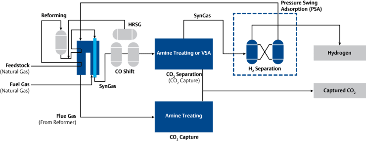

Hydrogen is almost exclusively produced through thermochemical processes requiring fossil fuels: hydrocarbon reforming, coal gasification, hydrocarbon pyrolysis, and plasma reforming. Approximately 95% of hydrogen is produced via steam reforming of hydrocarbons (Figure 1) with the balance coming from water electrolysis, biomass-derived liquid reforming, and microbial biomass conversion.
1. In the U.S., 95% of the hydrogen produced utilizes natural gas reforming to enable and meet the demand for hydrogen production. Courtesy: Emerson Automation, Appleton
The least expensive method of production is steam methane reforming (SMR). Besides methane, it is used to produce hydrogen from ethanol, propane, and gasoline. Although steam refining is very cost-effective, it requires fossil fuels as feedstock and to produce heat. In fact, for every kilogram of hydrogen produced in SMR, seven kilograms of CO2 are released into the environment. Carbon capture and storage (CCS) techniques seek to trap the vast majority of CO2 produced by SMR and store it in the ground, converting the product from “gray” to “blue” hydrogen (see sidebar).
