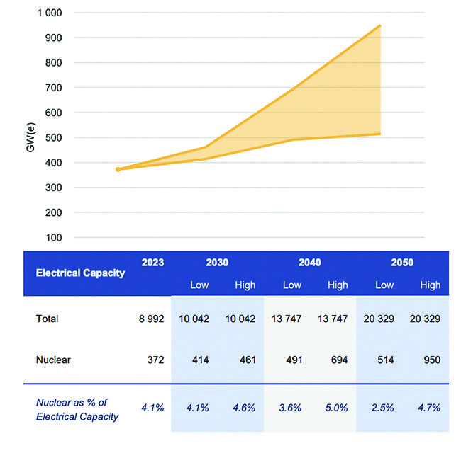

Nuclear energy is at an inflection point. In 2023, nuclear contributed 9.2% of the world’s total power production with an installed capacity of 371.5 GWe from 413 reactors globally. While that figure still represents a relative waning—especially if compared to nuclear’s share of 18% in the late 1990s—in September 2024, the International Atomic Energy Agency (IAEA) issued projections that point to a dramatic sectoral revival. While the agency’s high-growth scenario is ambitious—anticipating a rapid expansion that could reach up to 890 GW by 2050—even its conservative scenario is optimistic, envisioning 458 GWe by 2050 (Figure 1). The agency pointed to several prevalent drivers. Among them are climate goals that now recognize nuclear as indispensable to achieve COP28 pledges and growing international coalitions, including from 25 nations, that will work to triple nuclear capacity by 2050. Nuclear has been championed as a key solution to counter renewable variability and climate change resilience, and address energy security amid geopolitical strain.
1. The International Atomic Energy Agency (IAEA) projects that while total power capacity could increase by about 12% by 2030 and more than double by 2050, nuclear capacity could increase 2.5 times the 2023 capacity by 2050 in the high case and by about 24% by 2050 in the low case. Courtesy: IAEA
Proceeding with urgency, several countries have already acted to bolster their goals with a slew of supportive policy measures designed to manage financial and operational risks. In tandem, the nuclear industry’s long-missing market signals are growing more pronounced, riding on soaring energy demand projections from economic growth, urbanization, electrification, and lately, the scramble from tech giants to secure power for their energy-intensive data centers, and for semiconductor and chip fabrication.
