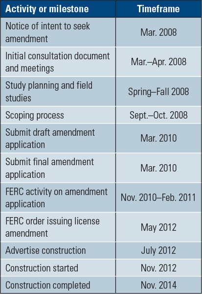

Sitka filed a notification of intent to apply for a capacity-related amendment to the Blue Lake Project license with the Federal Energy Regulatory Commission (FERC) in March 2008. That began the long and arduous process (Table 1) of getting approval to increase the height of the dam by 83 feet and construct a new powerhouse with three new turbines, which would increase the average annual generation by 54%. Just over four years later, FERC approved the request after the project sponsors had completed what seemed like an infinite number of meetings, studies, reports, and paperwork.
PWR_120115_TP_BlueLake_Table1
Table 1. No snap of the fingers. Source: City and Borough of Sitka

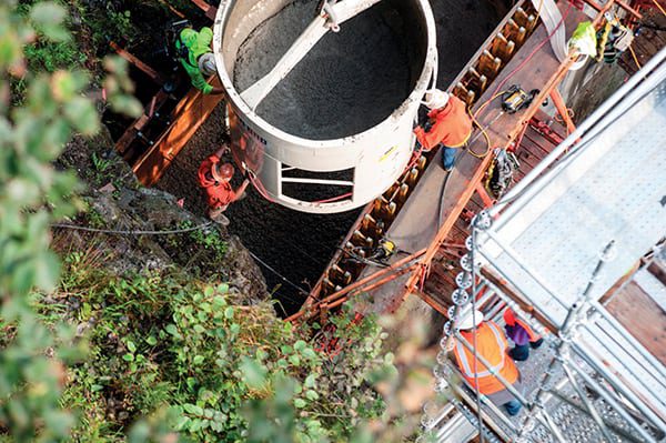

Barnard sourced a 600-ton lattice crawler crane from Alaska Crane for the job. With a boom length of 396 feet, it was the largest crane operating in Alaska at the time. The crane was indispensible for the project. It was used to deliver tunneling equipment to the team building a drainage tunnel in the plunge pool, as well as to set a smaller crane in place on a flexi-float barge, allowing crews to work from the upstream side of the dam. The crane was also used to deliver crews to various areas using a manbasket and, most importantly, to pour concrete into forms via an 8-cubic-yard bucket.

The aggregate, sand, and cement for the project were delivered to an industrial park located about 2 miles from the dam site. A batch plant was set up there to do the concrete mixing. Six different mixes were used, and quality control standards were monitored closely.
When each batch was ready, it was loaded in a concrete truck for transport. Workers had 90 minutes to get it into the forms. Orbison said it generally took about 40 minutes, so the team rarely had any trouble meeting the time restriction. In all, more than 9,000 cubic yards of concrete were placed, 8 cubic yards at a time (Figure 1).
Blue Lake Expansion Project
1. One bucket at a time. Concrete mixed at the batch plant was delivered to the site via truck and transferred to the 8-cubic-yard bucket so it could be dumped into the forms. Courtesy: Derek Olsen/Barnard Construction
