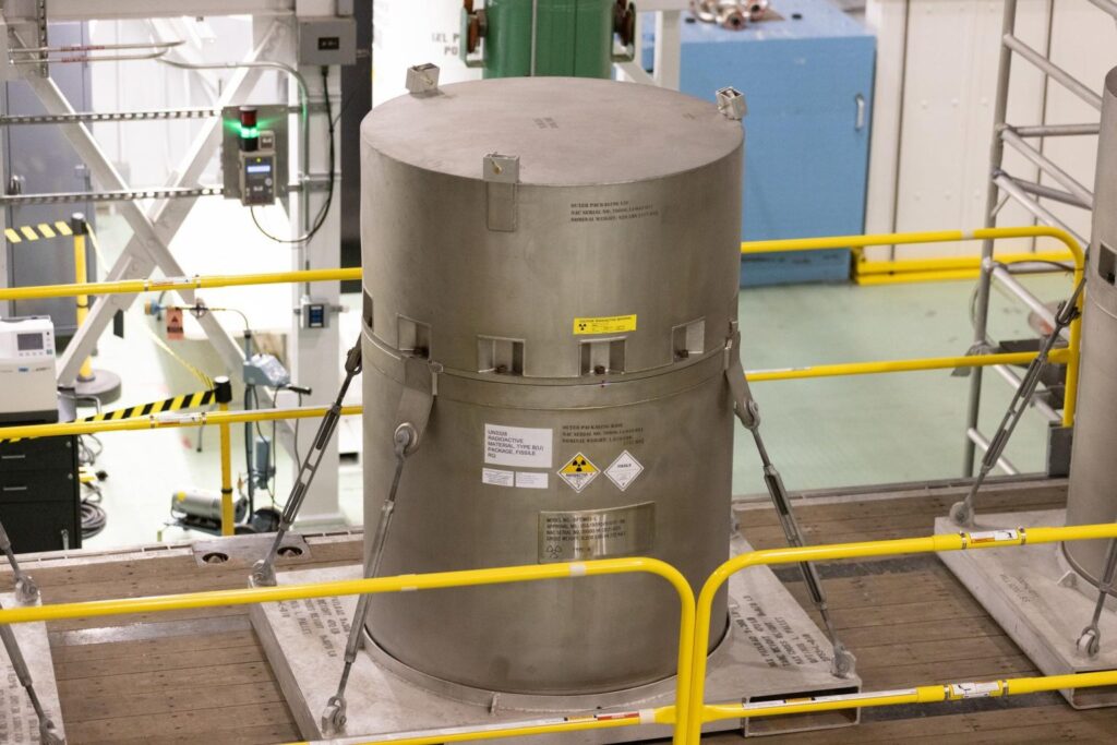

“A single cask can hold more than one-fourth of the TRISO fuel needed to fuel Project Pele,” INL notes. Source: INL/DOE
