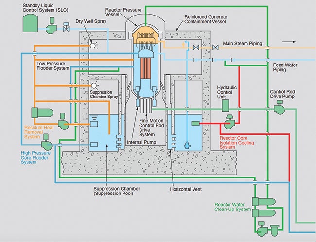

1. This is a graphic of the schematic design of an advanced boiling water reactor (ABWR). Hitachi said the ABWR’s features include a highly economical reactor core; reactor coolant recirculation system driven by internal pumps; advanced control rod drive mechanism; overall digital control and instrumentation; and a reinforced concrete containment vessel. Courtesy: Hitachi
Hitachi was the main contractor for development of the reactor system for Unit 2 (Figure 1). The company also served as the main contractor, architect engineer, and reactor system supplier for Shimane Unit 1. Hitachi also has served as the main contractor for the development of Shimane Unit 3 prior to construction being halted. Hitachi-GE was the supplier for components for upgrading Unit 2, including the control rod drives, or CRDs, which required a significant time commitment for inspection and cleaning before the restart of the reactor.
