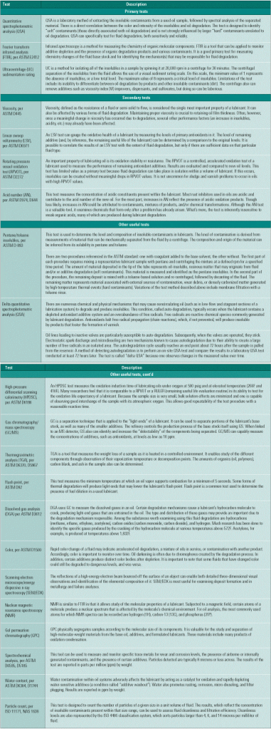

Table 2. Eleven commonly used flushing processes. Source: Noria Corp.
GP Sept 2013 F4 Oil Flushing table 2
Table 3. Effectiveness of alternative flushing processes described in Table 2. Source: Noria Corp.
GP Sept 2013 F4 Oil Flushing table 3
