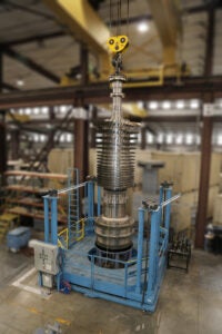

“If you’re not thinking two to three years down the road on your rotor, then you’re already behind, because that’s how long it’s going to take to manufacture those wheels,” Jason Wheeler, General Manager of Gas Turbine Rotor Repairs at MD&A, said as a guest on The POWER Podcast.

Wheeler noted that inspection technologies have evolved since these units were first installed, particularly in specialized non-destructive examination (NDE) techniques. MD&A partners with industry-leading NDE vendors that employ advanced volumetric phased array inspection, which Wheeler described as allowing inspectors to “basically fly through the part and look for imperfections.”
Beyond NDE advances, Fernandes pointed to improvements in reverse engineering capabilities, citing blue light scanning as one example of more precise methods that enable better component reproduction.
