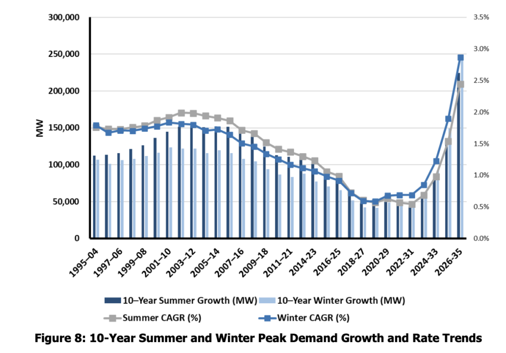

fter decades of relatively modest growth, NERC anticipates a dramatic spike in both summer and winter peak demand through 2035. Source: NERC LTRA 2025
After decades of relatively modest growth, NERC anticipates a dramatic spike in both summer and winter peak demand through 2035. The LTRA 2024 last year projected a 15% increase in summer peak demand over the next 10 years—a significant acceleration of 132 GW compared to the LTRA 2023, and a winter peak growth of 18% over the 10-year period: 149 GW, up from 92 GW in the 2023 LTRA. The LTRA 2025 projects a further acceleration. It projects summer peak demand will rise by 224 GW—69% compared to last year’s LTRA—and winter peak demand will increase by 245 GW, a 65% jump from the previous 10-year projection. Source: NERC LTRA 2025
Artificial intelligence data centers and the digital economy account for most of the projected load growth, but the report also identifies large industrial facilities, electrified transportation, cryptomining, heat pump deployment, and demographic trends as “primary demand drivers.”
However, the report cautions that demand projections rely on load forecasts from utilities and system planners based on information from the interconnection process and agreements between utilities and owners of connecting loads. “To be counted in load forecasting, data center projects have advanced from speculative and exploratory stages into development commitments,” the report notes. “Consequently, data center and large load growth forecasts in the LTRA are likely to be more conservative than predictions from the technology industry or from economic, research, academic, and policy organizations,” NERC warns.
“We see real load growth,” John Moura, NERC director of Reliability Assessment and Performance Analysis, told reporters during a briefing on Thursday. “We’re not counting every prospective data center, prospective demand, load center out there. We’re taking quite a bit of a haircut and looking at what’s reasonably expected to come in.” Even so, he added, “that uncertainty and kind of what we know—the magnitude of load growth—is increasingly uncertain and its impact on planning—is going to have a significant risk.”
The point of the LTRA, he noted, is to “evaluate where the system could face stress if conditions unfold as they’re currently planned,” he said. “It shows that risk trajectory—not certainties, and just as important, it shows that there is still time to act, and the results shouldn’t be taken as an indictment of those areas.”
The challenge, he predicted, “is not a lack of effort challenge. It’s really a pace and scale of the system transformation occurring at the same time as demand growth accelerates.”
