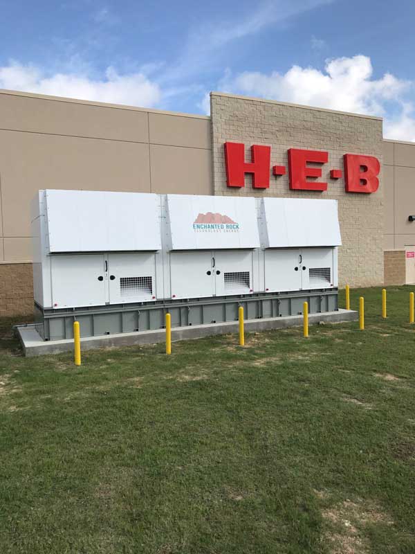

Enchanted Rock, which designs backup power systems for businesses, installed its microgrids at H-E-B supermarkets around Houston over the past year after signing a deal with the grocery chain in 2016. The systems receive natural gas from underground pipelines that are not affected by flooding or high winds.
An Enchanted Rock microgrid system is shown outside an H-E-B grocery store in Houston, Texas. Enchanted Rock has installed the natural gas-powered generation system at H-E-B stores and other businesses in Texas. Courtesy: Enchanted Rock

The natural gas feed enables the microgrid generators to operate continuously without the need to refuel, as opposed to diesel-powered generators that would require fuel deliveries during bad weather. Various types of microgrids have been utilized for years, and more recently have been discussed as a way to provide reliable power in the event of a natural or other disaster.
The company said it took H-E-B stores with the microgrids off Houston’s main power grid on August 25, as Hurricane Harvey made landfall along the Gulf Coast in southeast Texas, and switched the stores to Enchanted Rock’s on-site generators. Though San Antonio-based H-E-B closed stores on August 27 due to safety concerns as flooding worsened in Houston, several stores were able to reopen soon after thanks to the power provided by the microgrid.
