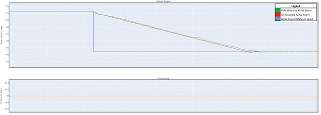

1. This sample of a hardware-in-the-loop (HIL) test chart shows modeled and field data overlaid. Courtesy: Merit Controls
Hardware-in-the-loop testing, also known as HIL testing, offers an exciting opportunity to fill this gap. HIL testing involves creating a closed loop between the hardware under test, in this case the power plant controller with the code set that will be deployed onsite, and a model of the plant. By using real-time simulation of an electromagnetic transient–based high-fidelity plant model, HIL testing can offer very-high-accuracy results based on actual plant physics (Figure 1) rather than mathematical equivalencies. HIL modeling is typically completed around the factory acceptance testing (FAT) stage of a project, enabling any necessary changes to be made and re-tested before the equipment arrives onsite.
