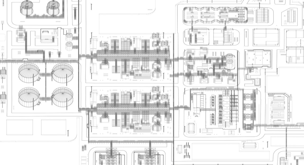

Integrating water chemistry early in the design process solves these challenges before they materialize (Figure 1). It enables better-informed engineering decisions, reduces operational risk, and supports long-term asset performance at a time when power plants must be more flexible, resilient, and efficient than ever.
1. Early integration of water chemistry requirements into plant design reduces costly retrofits and operational headaches down the road. Courtesy: Aquatech

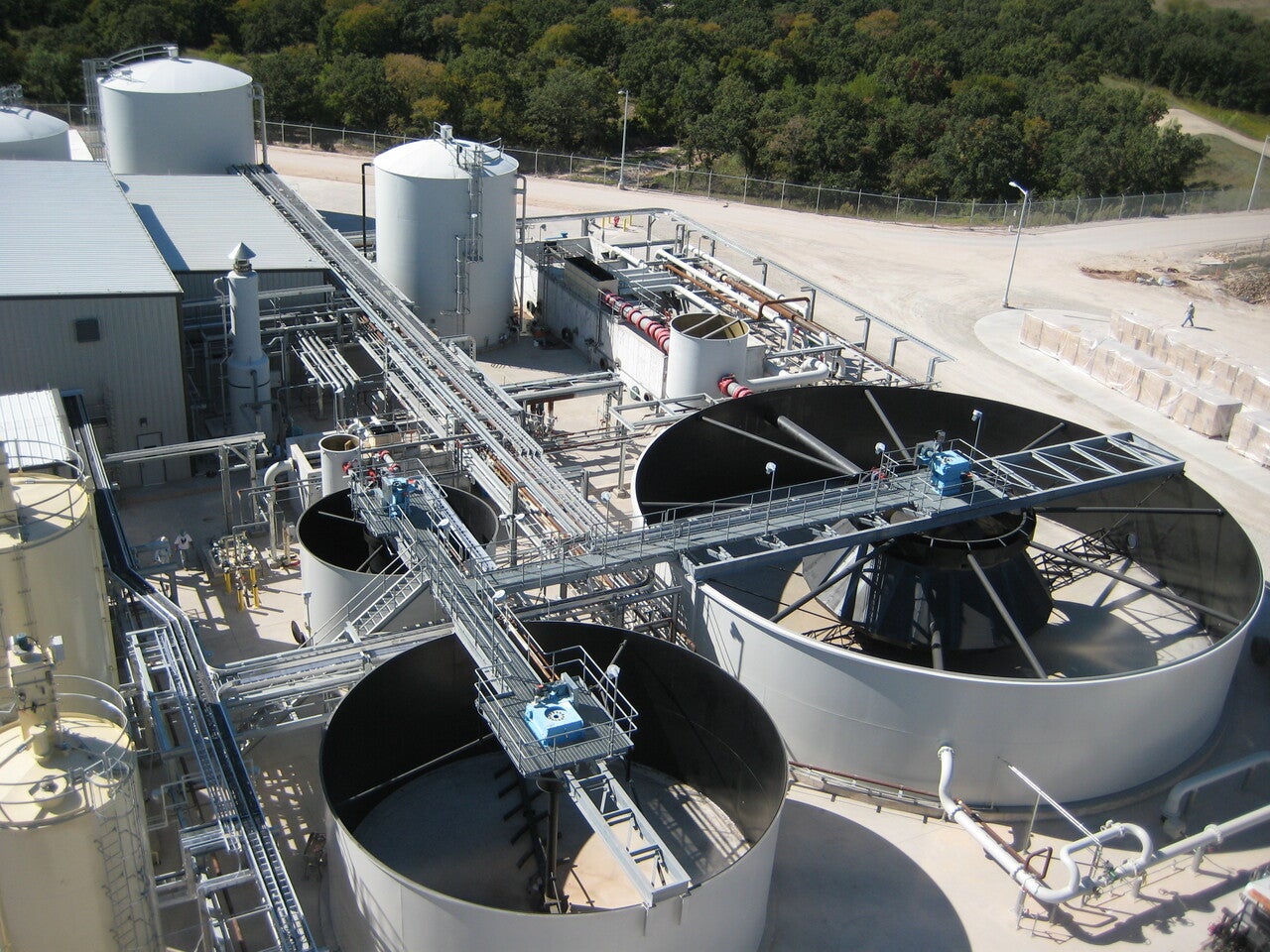

To embed a holistic design into your plant from the start, consider partnering with a full-service provider that manages water from front-end engineering design (FEED) through feedstock (Figure 2). This approach ensures seamless integration of equipment design, operation, and chemistry management—enabling synergy rather than in friction between critical systems.
2. Aquatech delivered the water treatment plant for the LS Power Sandy Creek Energy Station located in Northeast Texas. The project included a raw water makeup system with a makeup clarifier and gravity filter, fractional electrodeionization (FEDI), as well as a zero liquid discharge (ZLD) system. Courtesy: Aquatech

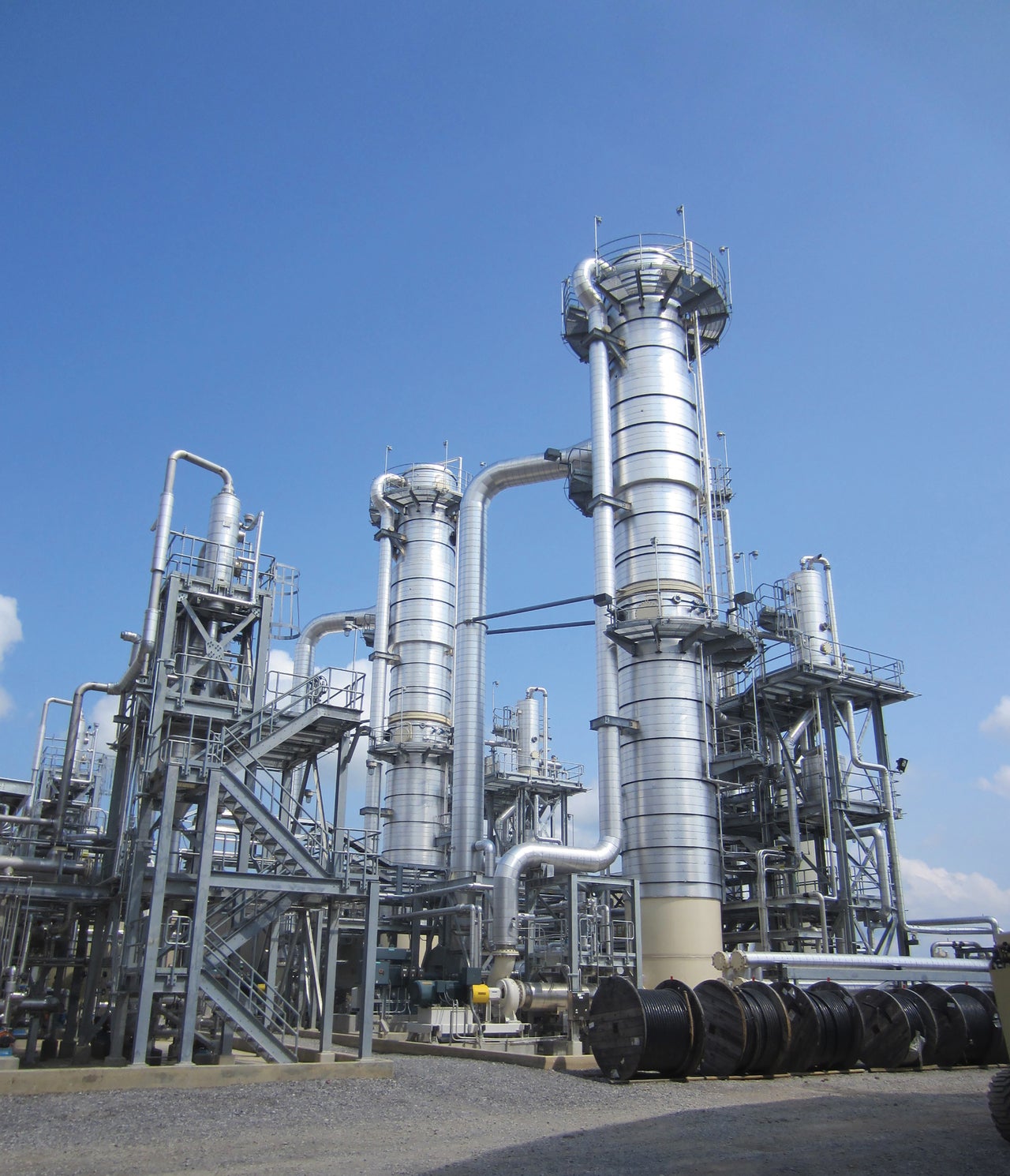

Integrating chemistry in the design phase ensures that injection points, feed systems, and containment facilities are considered alongside process piping (Figure 3). Automation and control loops can be designed early, allowing seamless integration with the plant DCS and reducing the risk of rework.
3. Aquatech successfully commissioned a complete makeup water treatment and ZLD facility at the 582-MW Kemper County energy project in Mississippi. Water treatment technologies included ultrafiltration (UF), reverse osmosis (RO), conventional demineraliza­tion, and thermal evaporation-based ZLD. Courtesy: Aquatech
