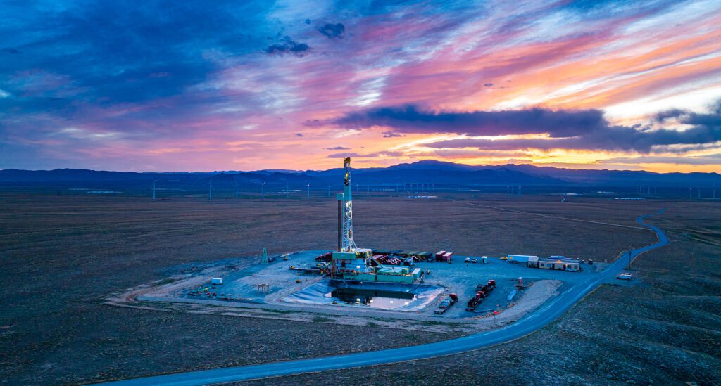

2. Project Red, co-developed by Fervo Energy and Google through a partnership forged in 2021 under the “world’s first corporate agreement to develop an enhanced geothermal power project,” in November 2023 began supplying power to the local grid that serves Google’s data centers in Nevada. Courtesy: Fervo Energy
In July 2023, Houston-based Fervo reported that Project Red—a nearfield EGS well pair drilled within a high-temperature, hard-rock geothermal formation in the Blue Mountain geothermal field in Nevada—achieved lateral lengths of 3,250 feet, reaching a temperature of 376F. It also proved controlled flow through rigorous tracer testing. The pioneering 3.5-MW EGS developed with Google reportedly began producing power in November 2023 (Figure 2).
