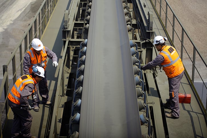

One company with experience in the conveyor industry is Martin Engineering. It is helping conveyor users reduce operating costs and improve safety with inspection and maintenance programs designed specifically for each individual system. A program they offer is called “Walk the Belt.” The service provides regularly scheduled assessments of belts, cleaners, tracking, chutes, dust control, and other components conducted by experienced specialists (Figure 1) with the training and expertise to maximize productivity and reduce downtime.
1. The Walk the Belt program provides scheduled reviews of conveyor systems to maximize productivity and service life. Courtesy: Martin Engineering

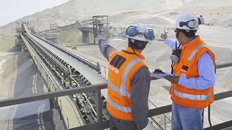

The technicians do more than just walk along the length of the belt though. One of their inspection techniques is standing stationary at a number of points along each conveyor and watching one or more complete revolutions of the belt, noting its condition, tracking, carryback, and other items (Figure 2). They take detailed notes, identifying trouble spots by component name and location as they are found, often logging data directly into a smart phone or tablet immediately at the site. Digital cameras and other devices allow the technicians to take photos, record video, make rough measurements, and perform other tasks. The findings are discussed with customers’ operations personnel and potential deficiencies are prioritized.
2. By taking responsibility for routine maintenance and inspection, technicians help customers maintain system performance, while minimizing unplanned shutdowns. Courtesy: Martin Engineering
