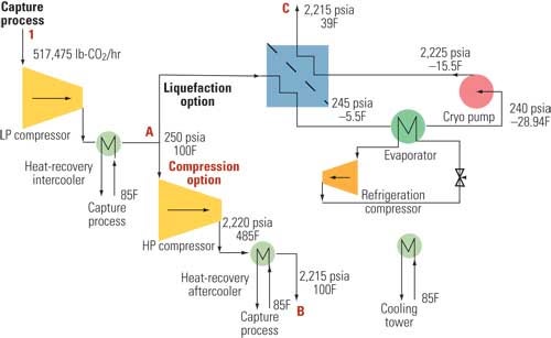

For purposes of comparison, we assume the initial ambient conditions are 100F and dry. Cooling water is assumed at 85F, if used. The CO2 gas mass flow is 517,475 lb/hr, or the equivalent of 90% capture on a 300-MW coal-fired power plant, burning Illinois #6 coal with a heat rate of 9,441 Btu/kWh (Figure 2).
2. Compare the alternatives. This flow diagram illustrates the typical compression process (A to B) and the typical liquefaction process (A to C) as design alternatives for a carbon capture system. Both processes begin with a low-pressure compressor and heat-recovery intercooler (1 to A). Source: Ramgen Power Systems LLC

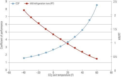

At the assumed operating conditions, the compressor adiabatic stage efficiency is calculated as 74%, per ASHRAE guidelines. We have used this stage efficiency at the 12.5:1 compression ratio required by R-22 at these conditions. At the liquefaction conditions described above, refrigeration efficiency is 2.003 kW/RT (kW per refrigeration ton), and the resulting refrigeration power required is 18,772 hp (13,998 kW). The refrigeration compressor efficiency for other operating conditions is scaled from a low of 72% at 220 psia to high of 83% at 800 psia and above (Figure 4).
4. Below freezing. Typical efficiency and coefficient of performance (COP) for a CO2 compressor for a given compressor outlet temperature. Source: Ramgen Power Systems LLC [Note that the legend labels were incorrectly identified in the print version of this figure. COP and kW/refrigeration tons are correctly identified here.]

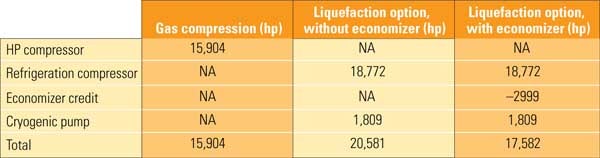

Table 1. Reducing CO2 compression power. Compressing CO2 from 250 to 2,215 psia with the Ramgen CO2 compressor is 9.5% more efficient than liquefying the CO2 and pumping it to pressure. These numbers do not include the LP compressor auxiliary power requirement that is common to both options (Figure 1). Source: Ramgen Power Systems LLC

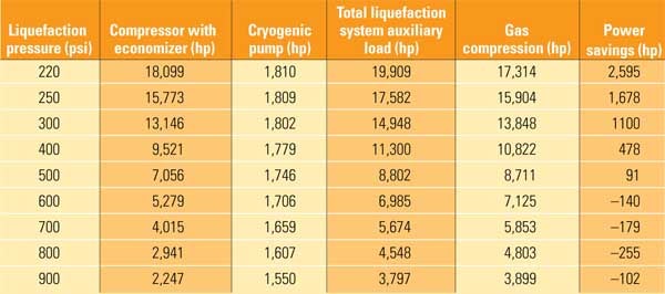

Table 2. Compression vs. liquefaction performance matrix. The compression auxiliary power advantage goes to gas compression at about 500 psi. These numbers do not include the LP compressor auxiliary power requirement that is common to both options (Figure 1). Source: Ramgen Power Systems LLC

As noted earlier, neither of these compression options includes the LP compressor auxiliary power, as that power has been assumed to be the same regardless of the high-pressure compression option selected (see Figure 2, process 1 to A). As an example of the magnitude of the LP compressor auxiliary power required, consider the extreme case of an 800 psia liquefaction pressure. That choice will require a conventional, six-stage integrally geared compression unit, estimated to require 26,413 hp or a Ramgen LP and intermediate pressure (IP) set of stages of comparable power to reach the 800 psia liquefaction level, a 3,000 hp chiller, and a 1,600 hp pump. The total power consumption of this configuration would be 30,961 hp.
The power consumption for the liquefaction option at 800 psia is 94.7% of the compression option, but the absolute value of the power consumption difference between compression and liquefaction from 800 psia to 2,215 psia is only 255 hp, as shown in Table 2. The added complexity to support a refrigeration loop may not be attractive in view of the minimal savings, elevated ambient temperatures, and system complexity.
