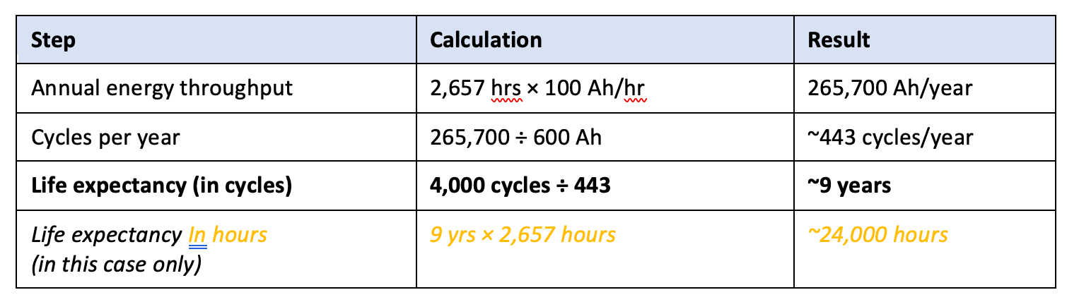

Your energy use per hour can be expressed in amp-hours, and your truck manufacturer has already defined it. If the recommended 600 Ah battery is sized to last one 6-hour shift — a typical spec — the truck draws about 100 Ah per hour. In real-life use, a Class I counterbalance truck draws about 90-120 Ah per hour. That’s your consumption rate — or better, get the real-life number from a power study of your truck in your facility.
Below is an example of a mid-size distribution warehouse that runs a 36V counterbalance truck 2,657 hours a year. The truck specification says it draws 100 Ah per hour, and its lithium battery is 600 Ah with a warranty for 4,000 cycles.
Four lines of arithmetic tell you everything:
The battery in this operation would beat a “20,000-hour” marketing promise by 20%. But move the same lithium-ion battery to a cold-storage operation and add a clamp attachment to draw 120 Ah per hour, and the math collapses to 20,000 hours, under the same 4,000-cycle rating. The cycle number never changed. The hours never meant anything.

Life (years) = Warranted Cycles / (Hours per Year × Energy Use per hour (Ah) / Battery Ah Capacity)
