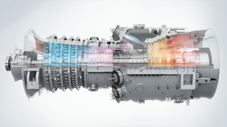

The Nishi Nagoya plant has two blocks of 3-3-1 7HA.01 multi-shaft gas turbines (Figure 1), with each block producing 1,188 MW. The plant also utilizes Toshiba’s steam turbine and generator technology.
Figure 1_Nishi Nagoya
1. Efficiency, reduced fuel consumption, fewer emissions. GE delivered six 7HA.01 gas turbines to Nishi Nagoya. The plant has two blocks of 3-3-1 7HA.01 multi-shaft turbines, with each block producing 1,188 MW. The turbines help increase the plant’s thermal efficiency, while reducing fuel consumption and CO2 emissions compared to other thermal power technologies. Courtesy: Chubu Electric Power
