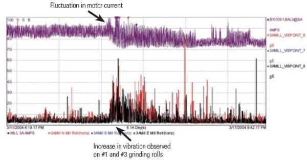

Five days after installation of the SKF system, the pulverizer experienced a failure of the bearing of its #2 grinding roll. The wireless vibration monitoring system was instrumental in notifying plant personnel that a change in the operating characteristics of the pulverizer had occurred. A review of the PI historian showed correlations between changes in pulverizer motor current and vibration trends on the inboard motor bearing, outboard worm shaft bearing, and the #1 and #3 grinding rolls. This prompted Unit 3’s predictive maintenance (PM) engineer to take more in-depth vibration data with a portable analyzer.
Motor current also was plotted along with vibration data from the #1 and #3 grinding rolls. Even though the failure was in roll #2, vibration from the failed roll was strong enough in adjacent rolls for the MCTs to detect it (Figure 5).
5.	Good results. The correlations between motor current and bearing-related vibration data (top) and between motor current and grinding-roll vibration data (bottom). Courtesy: SKF USA Inc.
