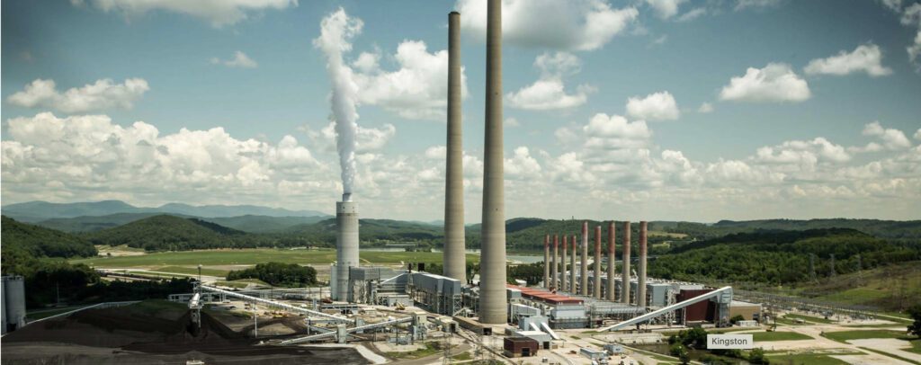

TVA’s 1.3-GW Kingston Fossil Plant, slated for retirement in 2027, is located on the Clinch River arm of Watts Bar Reservoir near Kingston, Tennessee, on approximately 800 acres. When it was finished in 1955, Kingston stood as the largest coal-burning power plant in the world—a distinction it held for more than a decade. Source: TVA
