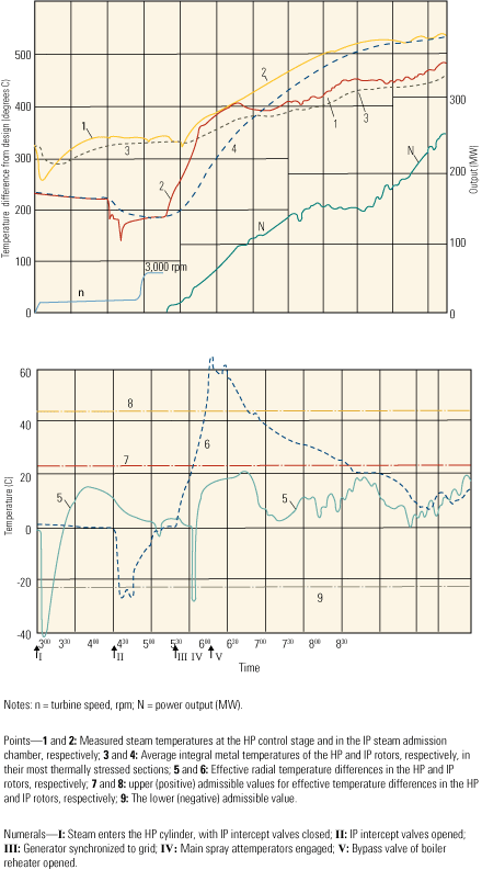

All of the above-mentioned methods of steam turbine temperature monitoring have been used in long-term operational practice at many power plants. In particular, there is a long and detailed history of applying analog and digital devices for temperature monitoring of the HP and IP rotors at standard Soviet 300-MW supercritical-pressure steam turbines. Some of these devices have been in service for over 25 years. Recorded data of such regular monitoring for sister turbines at several power plants were used to calculate specific lifetime expenditures of rotor metal caused by low-cycle (thermal) fatigue as applied to characteristic cycles of transients.
At some power plants, the transients ran practically without regard to temperature monitoring of the rotors; at others, the transients were run with the feedback based on monitoring data. The results of these calculations (see table) illustrate that in the first case the values of specific low-cycle fatigue were up to two orders of magnitude greater than in the second case. It’s also important to note that, without temperature monitoring of the rotors, operators and engineers usually failed to notice the operational errors (see box) that caused undesirable steam temperature excursions, inadmissible thermal stresses in the rotors, and resultant increased lifetime expenditures. With on-line temperature monitoring of rotors, the turbine transients were endured with greater load change rates and lower fuel losses and turbine lifetime expenditures.
