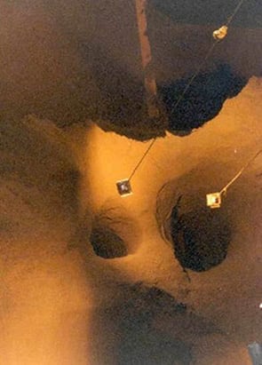

Although the huge bunker has a potential capacity of 4,000 t, the true useable capacity of the 3,000-t section was nearer to 1,500 t. This was due to the phenomenon of “rat holing” (Figure 2), where a significant quantity of the contents was effectively trapped around the periphery of the bunker with only the central core of coal directly above the outlets flowing from the bunker into the charge cars. This meant that only a modest portion of the bunker’s contents was retrievable—that which could flow through the 64-cm diameter outlet via a flow channel that flares to approximately 1-m diameter over a depth of up to 10 m. The bunker geometry and construction caused the residue to remain, even when the central flowing channel was emptied (rat holing). Occasionally, the narrow flow channel itself would arch, preventing flow completely.
2. Rat holes formed in the bunker. Courtesy: Tata Steel

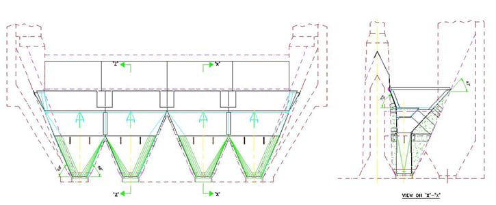

At Scunthorpe, a three-stage design with an insert was devised by Ajax. The first mass flow sections produced plane flow converging to the existing outlets. The form of these sections was such that two adjacent outlet sections were joined together to provide one slot.
The second mass flow stage expanded the flow channel to a reliable flow width and connected a full row of four outlets together. To destabilize any large rat hole that might form, a third stage was added, which would not be mass flow, but instead would provide self-clearing of the remaining hopper contents. Due to the offset outlet construction, a further set of inserts was fitted to reduce compacting pressures in the outlet region and encourage flow from the shallow side of the hopper (Figure 3).
3. Drawing of bunker with insert system. Courtesy: Ajax Equipment

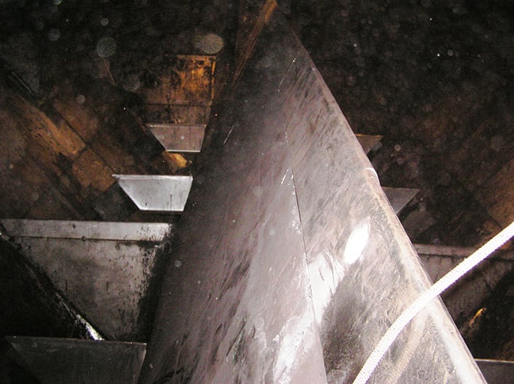

Installation and Performance of Inserts
The first row of inserts made such a huge difference to improving the flow of coal from the bunker that a financial case was put together to line three more rows of outlets. There are now two rows of inserts in the 3,000-t section and two rows in the 1,000-t section (Figure 4).
4. Two rows of inserts installed in the 1,000-tonne section. Courtesy: Tata Steel
Prior to fitting the inserts, poking for coal was required at least once per shift from November to March. This is no longer necessary. Moreover, no reportable injuries have resulted from poking activities in the service bunker since the inserts were installed in 2009.
When poking for coal, there was a tendency for the charge cars to be underfilled. This resulted in the ovens not being filled to the required standard, lower coke yield, and subsequent refractory damage to oven chambers. Since the inserts have been installed, better filling of the charge cars has occurred, resulting in improved oven filling and a higher coke yield. The live capacity of the 1,000-t section is now approaching 80%.
