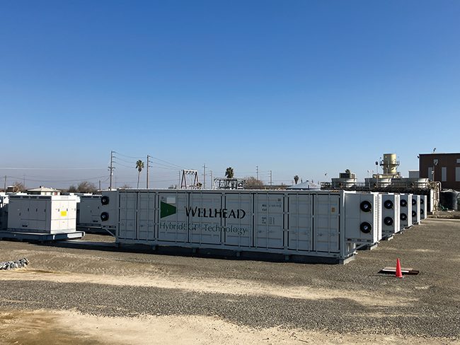

1. Wellhead’s 16-MW/16-MWh hybrid Electric Gas Turbine (EGT) battery system provides an economic pathway to speed up the energy transition while maintaining grid reliability. The EGT increases efficiency, reduces emissions, and achieves high-speed performance. Courtesy: Wellhead Power Solutions
MCE created the hybrid project in partnership with Wellhead Power eXchange, part of Wellhead Electric Co., using Wellhead’s Hybrid Electric Gas Turbine (EGT) technology (Figure 1) that was co-developed with General Electric. The battery shortens the amount of time the natural gas plant is operating, and increases the quality of the plant’s reliability services, which support wind and solar generation. The integrated battery storage system, operated by proprietary software, provides an array of reliability benefits that neither turbines nor batteries can provide on their own.
