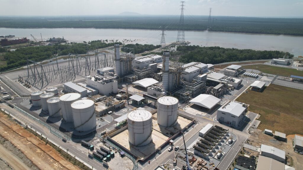

A big draw to select 9HA.02 gas turbines (Figure 1)—though demonstrated only once worldwide at Track 4A—was “GE offered the most competitive offer in terms of technical and commercial aspects,” Anbarasan noted. Crucial for plant performance was that the 9HA.02, rated at 838 MW under International Standards Organization (ISO) conditions, pushes net efficiency beyond 64%. The technology also offers a hot-mode startup time of less than 30 minutes, a fast ramp rate of up to 88 MW per minute to cater for automatic generation control (AGC) and immediate frequency response to support the grid, and a low turndown to minimum emission-compliance load.
According to Edra, the 9HA.02’s standard dry low-NO x (DLN) 2.6e+ combustion capabilities were also well-suited for compliance with Malaysia’s clean air regulations. As significantly, its flexibility capabilities include a standby and response mode of less than 15% load and hydrogen readiness of up to 50%. At the Melaka plant, prominently, GE’s supplied HRSGs “are designed to provide reliable high-cycling duty due to the innovative single-row harp configuration in the front (hot) end of the HRSG, producing three times less stress than conventional multi-row harps,” the OEM told POWER. The design is tailored for fast starts, rapid response, and low turndown, it said.
1. Three power plants running seven GE 9HA.02 high-efficiency, air-cooled gas turbines are currently in commercial operation: Track 4A (2021) and Edra Melaka Power Plant (2022) in Malaysia, and Bang Pakong in Thailand (2022). GE says that the HA fleet has reached over 2 million operating hours, and so far, the 9HA.02 fleet has completed more than 100,000 running hours for the seven units in commercial operation plus four units currently in commissioning. Courtesy: GE Vernova
