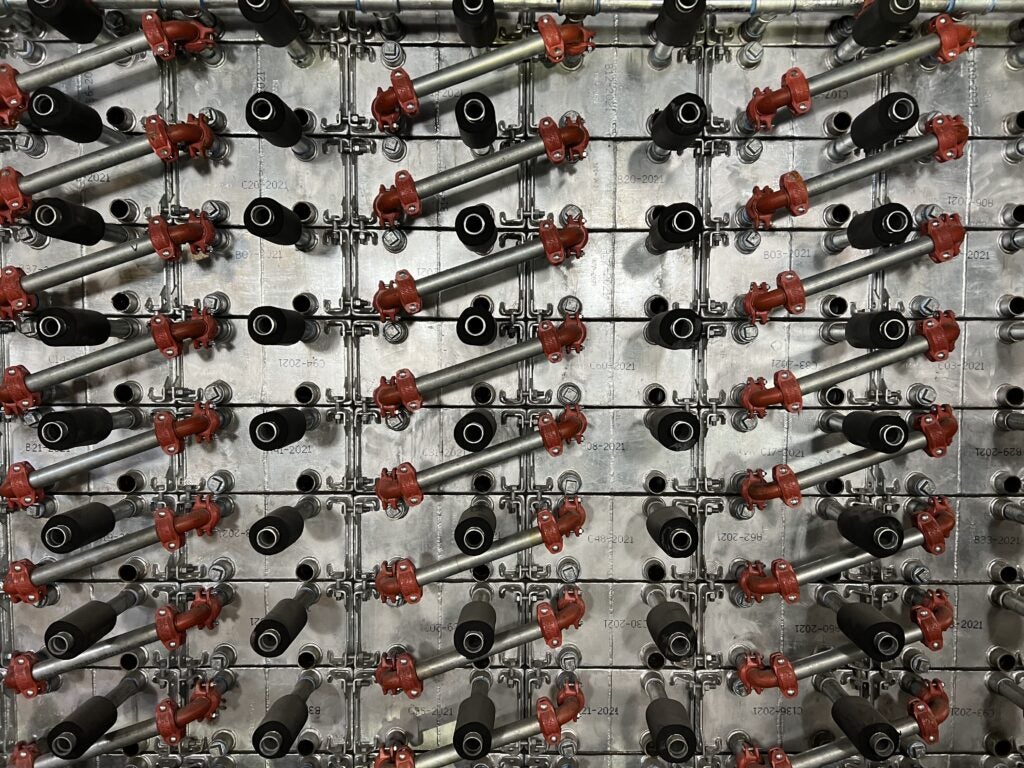

This image provides a detailed look at the Icebrick thermal energy storage system. Source: Nostromo Energy
