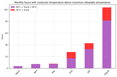

In a study conducted by Laki Power, the performance of a 200km power line was analyzed over an 8-month period. It was found that for 3.3% of the time, DLR was lower than the SLR, causing the conductor temperature to exceed its thermal rating. This corresponds to 191 hours during which the conductor could have operated above its maximum allowable temperature of 80°C, despite being within the SLR limit.
According to the datasheet, the emergency operation temperature for the ACSR “Condor” conductor is 90°C and should be limited to 10 hours or less per year. Assuming the power line was operating at SLR, calculations based on historical weather data showed that during this 8-month period, the power line would have exceeded its emergency rating for 43 hours.
The number of hours where the DLR was below SLR in specific months. Source: Laki Power DLR Feasibility Study
This study illustrates that the DLR’s value extends beyond merely increasing the transmission capacity, it can also detect when the DLR falls below the SLR, which is crucial for preventing potential damage to the infrastructure and enhancing overall system reliability. By closely monitoring and adjusting to actual line conditions, DLR helps maintain the line within safe thermal limits, thus reducing the risk of overloading, which can lead to costly repairs and downtime disrupting service to thousands of customers.

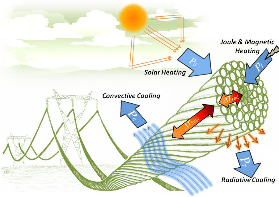

The conductor’s temperature is affected by various external conditions, one of them being weather, wind in particular. A conductor is subject to two heat sources and two cooling sources. The heat sources are heating from the sun and heating from the current on the line and the cooling sources a convective cooling from the wind and radiative cooling which is driven by the ambient temperature. If the ambient temperature is colder than the conductor, you will have a cooling effect. The interplay between these heat sources and cooling methods determines the conductor’s temperature and, by extension, its operational capacity and safety clearances.
How heating and cooling affect the conductor. Source: CIGRE Guide for Thermal Ratings Calculations of Overhead Lines
Most grid operators use SLRs for the maximum ampacity which incorporates predefined conservative weather conditions. However, most of the time there is higher wind speed and lower ambient temperature than defined in the SLR, meaning there is a capability to transmit more power through the line. Therefore, by integrating accurate real-time weather intelligence such as wind speed and wind-to-line angle into their DLR systems, grid operators will optimize their capacity and preserve the infrastructure by preventing the possibility of conductor damage. In times of extreme weather conditions, this responsiveness is essential for maintaining system reliability and extending the life span of the infrastructure.

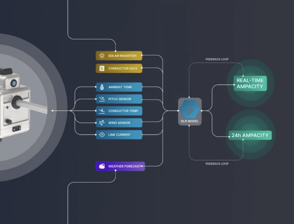

The micro-climate variations along transmission lines can be significant, especially in geographically diverse regions. Third-party weather data and weather stations located miles from the transmission line might miss these nuances, leading to a one-size-fits-all approach in weather assessments that could compromise the accuracy of DLR. Utilizing micro-climate wind data, as captured by devices like the LKX-MULTI, allows for a much more localized and precise adjustment to line ratings and forecasts.
The LKX-MULTI’s DLR model utilizes third-party weather forecasts and localized weather data to continuously improve its real-time ampacity and 24-hour ampacity prediction forecast models. To validate and improve its predictions and overall DLR model, real-time wind measurements from the LKX-MULTI are compared to third-party forecasted wind measurements, and the difference is fed into the DLR model, creating a feedback loop for continuous improvement of the DLR predictions.
Laki Power’s dynamic line rating model. Source: Laki Power
This level of detail is crucial for tailoring operations to the specific conditions each segment of the grid faces, which in turn enhances safety and efficiency.
