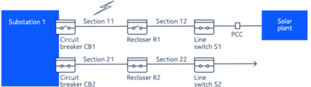

Imagine a scenario where an array of solar panels is attached at the downstream end of the circuit to a traditional substation that is providing power to a neighborhood feeder circuit (Figure 2). If the distribution automation system detects a fault incident in Section 11, it will send trip commands to open circuit breaker (CB1) and recloser (R1) to isolate the fault. Then, if the solar array inverter does not detect island formation, it would still feed power through the point of common coupling (PCC) and into circuits downstream from the recloser. This creates an electrical island—a hazard for the line crews dispatched to deal with the fault, as well as for the local electrical equipment on that section of the feeder, which can experience out-of-range voltage and frequency.
2. A DER energizing an islanded feeder circuit. Courtesy: Nokia
Direct transfer trip (DTT) is one way to protect against this islanding. Originally designed for high-speed tripping of generator and substation circuit breakers, in this situation, after a fault is detected, DTT sends a trip command to the downstream switch S1 telling it to open along with the circuit breaker and recloser—stopping the DER from energizing the feeder.
