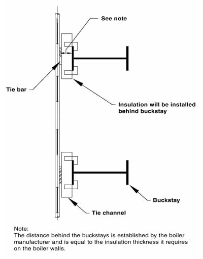

2. Typical insulation installation drawing for a boiler wall with buckstays. Courtesy: BRIL Inc.

All boiler OEMs specified and documented the insulation thickness and material requirements on their steam-generating boilers. Each developed company standards for the type of insulation and the acceptable application procedures for installing insulation. These standards and application procedures were provided with each boiler they sold, whether the insulation was in their scope of supply or not. This practice is still true today.

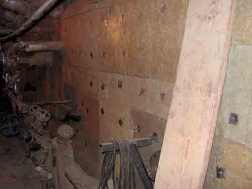

Going to a double layer also often increases the number of gaps and can increase the incidence of improper insulation applications. This situation occurs when the first layer of insulation is installed in a shoddy manner, followed by the second layer that forever hides the poor craftsmanship. Unfortunately, this occurs all too frequently, and only good supervision will prevent this situation from becoming epidemic on a job site. The following photo sequence illustrates how the improper installation of a double layer of insulation occurred during construction of a recent power station. Each of these examples violates the OEM installation specification (Figures 4 to 11).
4. A double layer of insulation was installed with a gap between boards on the outer layer. Courtesy: BRIL Inc.
5. Note the gaps between the boards of the outer layer of insulation. These gaps provide a path for the heat energy to bypass the insulation and cause hot spots on the outer surface of the boiler. Courtesy: BRIL Inc.
6. An exposed gap between boards on an inner layer of insulation was found during an inspection. Courtesy: BRIL Inc.
7. An insulation clip was not used to hold the first layer of insulation in place before the second layer was installed. Courtesy: BRIL Inc.
8. Another instance of the second insulation layer added without an insulation clip to hold the first layer in place. Courtesy: BRIL Inc.
9. On this boiler wall, the contractor did not use a half-board to start the second layer of insulation at the corner to ensure joints between layers do not line up. When two joints line up, the hot side is provided a direct, uninsulated path to the cold side. Courtesy: BRIL Inc.
10. An outer layer of insulation is turned in the wrong direction on this wall. Each layer should be oriented in the same direction. Courtesy: BRIL Inc.
11. The contractor used a cheaper insulation clip to hold the first layer of insulation in place, expecting it to be covered by the second layer of insulation. Courtesy: BRIL Inc.
