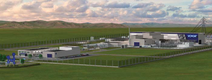

NuScale’s VOYGR small modular reactor
NuScale’s VOYGR small modular reactor was the first SMR to receive design approval from the U.S. Nuclear Regulatory Commission. Courtesy: NuScale
