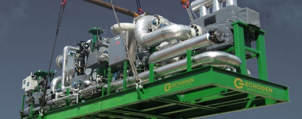

Waste-to-Heat Recovery Cycle. A system developed by Ohio-based Echogen Power Systems is a multi-stage recuperated closed-loop Brayton cycle where heat from an industrial plant’s exhaust stream is recovered though an sCO2 heat exchanger. According to the company, “the turbomachinery pumps the liquid CO2 to high pressure and passes through a combination of recuperators and waste heat exchangers (without using a secondary oil loop) before entering the turbo-expander, which drives the shaft that in turn drives a generator. Effluent CO2 exits the turbine, and passes through a series of recuperators to exchange more heat, and finally enters the condenser where it is converted back to liquid CO2.”

The U.S. Department of Energy (DOE) has also furnished Echogen and Southern Research with $1 million as part of the SunShot initiative to design, model, and test a novel integrated sCO2 power cycle and thermochemical energy storage system for concentrated solar power. According to the DOE, the award period is slated to end in October 2019. The team is expected to design, build, and test a prototype-scale sCO2 power cycle and reactor to validate the design and performance of the system. Echogen, meanwhile, already produces the 7.5-MWe EPS100, the first megawatt-rated commercial-scale sCO2 heat engine.
