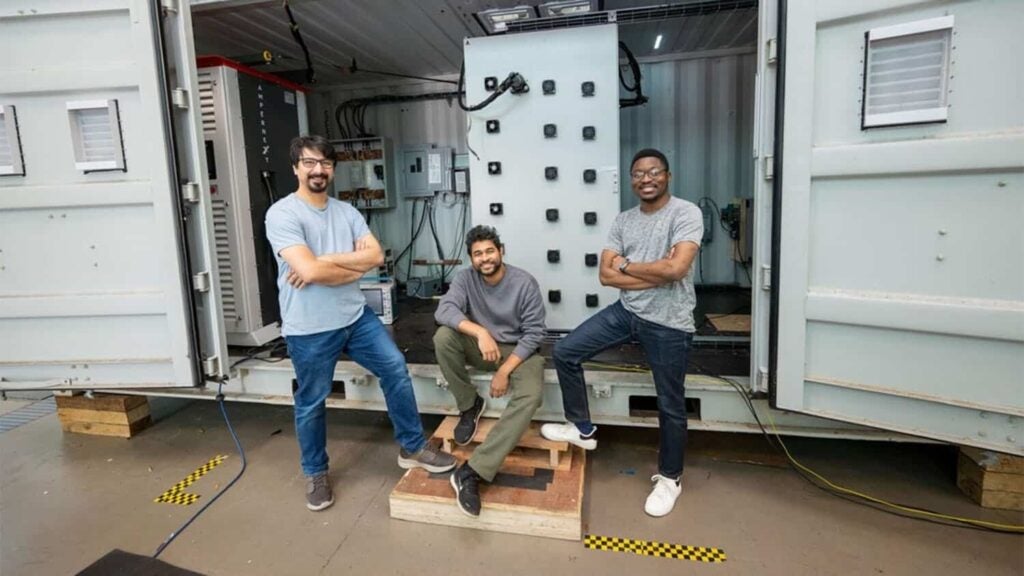

Three NC State researchers stand in front of the megawatt-class solid-state transformer developed for field testing on a utility distribution feeder.
Srdjan Lukic, principal investigator on the SST project and Lampe Distinguished Professor of Electrical and Computer Engineering at NC State, and other NC State researchers stand in front of the megawatt-class solid-state transformer developed for the NYPA-supported demonstration. Unlike a conventional arrangement that uses separate equipment for voltage transformation and AC/DC conversion, the SST integrates those functions through power electronics and high-frequency isolation. The prototype was later connected to a live 13.2-kV distribution feeder at EPRI’s power delivery laboratory in Lenox, Massachusetts. Courtesy: NC State University

Alt Text: Megawatt-class solid-state transformer equipment installed inside an open enclosure at EPRI's power delivery laboratory in Lenox, Massachusetts.
The NC State-built megawatt-class solid-state transformer at EPRI’s power delivery laboratory in Lenox, Massachusetts. During the three-day field campaign, the unit was connected to a 13.2-kV distribution feeder, supplied an EV load, injected reactive power, and was energized and de-energized at least 10 times. Courtesy: New York Power Authority
