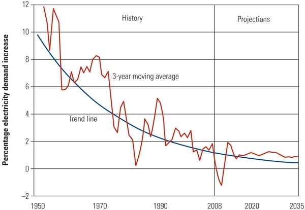

Electricity Demand Rebounds
So what’s ahead? Let’s start with demand for electricity, the major driver of business decisions about generation, including whether to build new plants, retire old ones, or change the mix of technologies used to make power. The dominant factors in electric demand are the state of the U.S. economy and the weather. The “Great Recession” is still being felt, and annual economic growth is likely to be around 2% for 2011, according to many estimates.

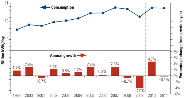

As for the weather, last summer was unusually hot (following an unusually cool summer 2009), which drove increased use of air conditioning, causing the U.S. Energy Information Administration (EIA) in its November 2010 Short Term Energy Outlook to raise its 2010 yearly electricity forecast to a 4.7% increase, up from 4% in August. Assuming that temperatures in 2011 will return to normal, the EIA is forecasting electric demand growth for the year to drop to –0.1%, down from a modest 0.4% predicted in August (Figure 1).
1. Electricity consumption grows. Total U.S. electricity consumption grew in 2010 after two straight years of decreases. Electricity consumption in 2011 is predicted by the Energy Information Administration (EIA) to be approximately the same as in 2010. Source: EIA, Short-Term Energy Outlook, November 2010
Long-term EIA assessments predict that 2011 will be the last year of about zero growth in electricity generation; future predictions trend back to 1% through 2035 (Figure 2). The North American Electric Reliability Corp. (NERC) 2010 Long-Term Reliability Assessment released in October is consistent with the EIA predictions that summer peak demand will grow by 1.34% per year and annual net generation will grow by 1.57% through 2019. That means no bubbling economy to spur electric demand. Another concern: NERC recently concluded that the Environmental Protection Agency’s (EPA’s) preoccupation with regulating coal-fired power plants will likely reduce the reliability of the nation’s grid (see the NERC sidebar).
2. Slow future growth. The EIA predicts that electricity growth, though stagnant in 2011, will resume long-term growth of about 1.5% per year. The data are based on a three-year moving average. Source: EIA, Short-Term Energy Outlook, November 2010
The slow-as-Venezuelan crude economy influenced energy use across all sectors. Lawrence Livermore National Laboratory (LLNL) in September reported that total U.S. energy consumption in 2009 (the latest year for which data are available) was 94.6 quadrillion Btu, down from 99 quads in 2008. “Energy use tends to follow the level of economic activity, and that level declined last year. At the same time, higher efficiency appliances and vehicles reduced energy use even further,” said A.J. Simon, an LLNL energy systems analyst who develops the energy flow charts using data provided by the Department of Energy’s (DOE’s) Energy Information Administration. “As a result, people and businesses are using less energy in general.” Simon elaborated: “Simply said, people are doing less stuff. Therefore, they’re burning less fuel.”

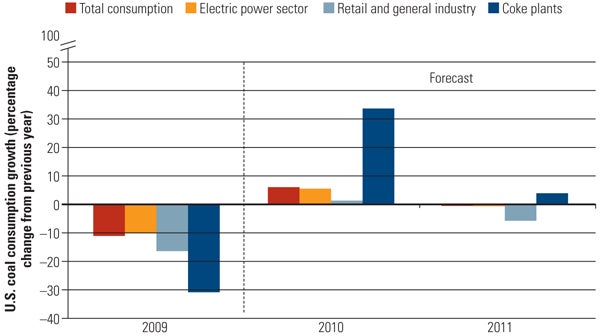

The generating story for 2011 starts with coal, the fuel that just won’t quit. During 2010, green forces again tried, and failed, to commit energy regicide, but Old King Coal again survived. It’s dirty to burn, it’s hard to handle, its extraction disrupts the earth. But coal packs a wallop in terms of energy density, and it is relatively cheap, meaning that coal is still the dominant fuel for baseload generation of power. This year shapes up as offering no reason for coal plants already in operation or in the construction pipeline to disappear wholesale, although some retirements and plant cancellations are likely, due to specific business conditions (Figure 3).
3. Coal use remains flat. Coal consumption will remain flat in 2011, according to EIA predictions. Data are presented as a percent change from the previous year. Source: EIA, Short-Term Energy Outlook, November 2010
Look for coal to continue its hegemony well beyond 2011. Few new projects are likely to be announced this year or next, but a large group of projects are under way. Most are likely to get finished and enter service. A year ago, the DOE’s National Energy Technology Laboratory (NETL) southwest of Pittsburgh updated 2002 and 2007 reports on coal-generating plants with conclusions drawn from its extensive plant database. The key finding of last year’s NETL report was the growing gap between announced projects and commissioned plant capacity. The NETL report, “Tracking New Coal-Fired Power Plants” (available on the NETL website) noted: “Actual plant capacity, commissioned since 2000, has been far less than new capacity announced.” The 2002 report showed over 36,000 MW of new coal-fired capacity scheduled to be installed by 2007. Only about 4,500 MW actually got commissioned.
