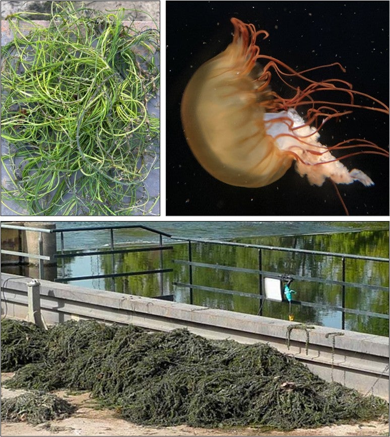

The primary operational challenge for operators of intake screening equipment is managing waterborne debris or aquatic life (Figure 1). Large debris influxes can occur episodically or seasonally and vary depending on the type of waterbody (such as reservoirs, rivers, lakes, or oceans). Increasing ecological variability, including extreme weather and biological responses to it, is intensifying these challenges. Long-term environmental shifts like changes in salinity, temperature, and species composition will further complicate management of debris influxes.
1. Various types of waterborne debris and aquatic life that can impact cooling water intake structures (CWIS) include non-native aquatic vegetation (top left) and jellyfish (top right). At some locations, aquatic vegetation can develop a large biomass in river systems, die off during droughts, become waterborne during floods, be transported downstream quickly, and arrive suddenly at CWIS (bottom). Courtesy: TWB Environmental Research and Consulting Inc.

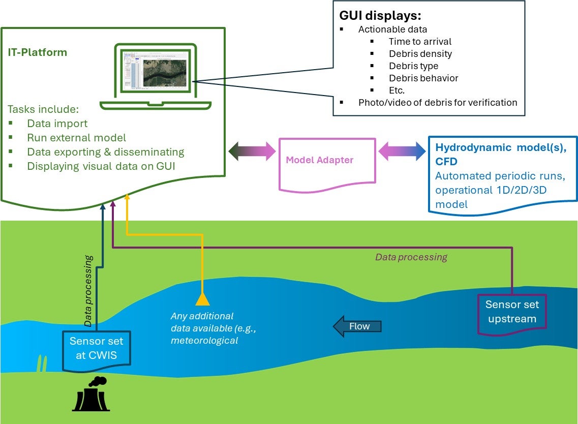

Assembling a Forecasting System for Debris Events
Debris events typically arise suddenly, prompting reactive measures to protect screening equipment. A forecasting system would provide operators the opportunity to adjust equipment settings, mobilize personnel, and plan for mitigating actions to avoid potential plant derates. It also allows operators to decide whether to continue operation if the verified debris loads will not overwhelm the equipment.
Such a system would combine real-time field measurements of abiotic and biotic parameters with hydrodynamic and hydraulic modeling to predict debris trajectory, speed, density, arrival at the intake, and duration of the event. A functional forecasting dashboard integrates sensor data and model outputs via a site-specific algorithm, issuing alarms based on thresholds validated by empirical sensor detection to minimize false positives. A forecasting system also presents the viewer with detailed, actionable information (such as time to arrival).
Forecasting tools range from highly site-specific models to robust platforms that are customizable across multiple sites. Publicly available oceanographic and meteorological data can be used to support routing and timing predictions.
The Electric Power Research Institute (EPRI) has published guidance, manuals, and best management practices on debris event forecasting and is currently conducting a multi-phase project that seeks to integrate in-situ sensors with hydrodynamic models and an information technology (IT) platform to provide real-time, actionable warnings supported by visual evidence such as photos and videos. Figure 2 provides a schematic overview of such a forecasting system.
2. Conceptual schematic of a forecasting system on a river. Courtesy: Pecten Aquatic and TWB Environmental Research and Consulting Inc.

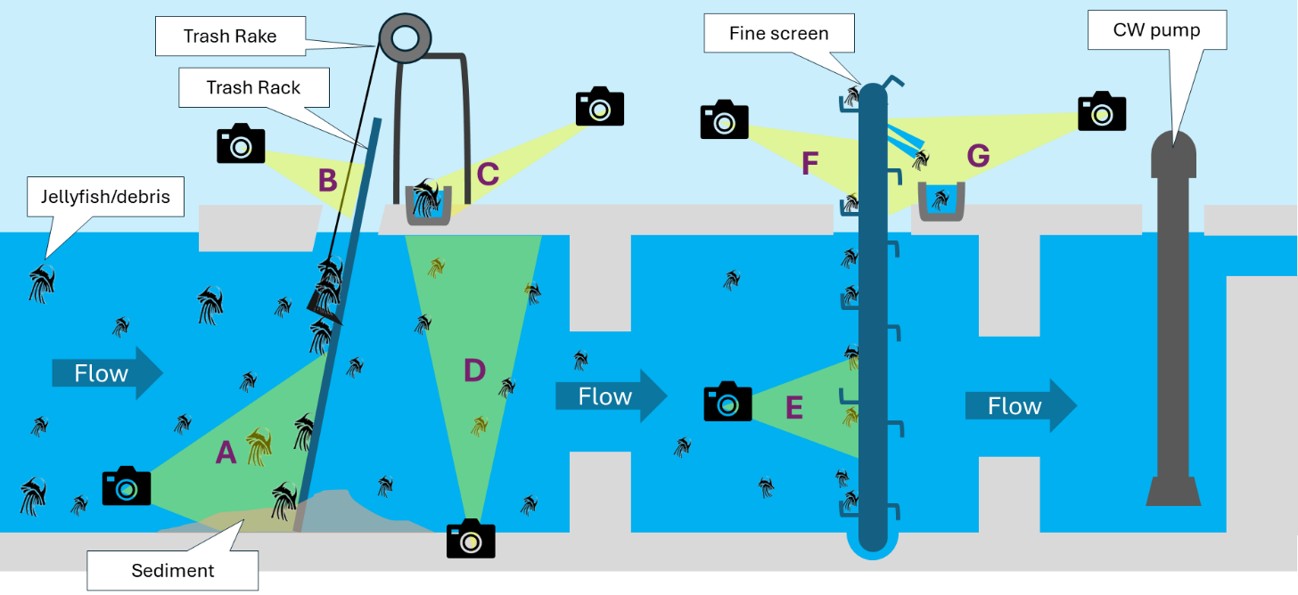

Beyond traditional, periodic inspections, advanced camera systems can be used for continuous monitoring of submerged intake equipment as well. For continuous monitoring, cameras are equipped with automated lens cleaning systems that use mechanical brushes or ultraviolet (UV) light to prevent fouling and maintain image quality. Continuous optical monitoring can allow assessment of:
  • Debris particle sizes and density trends.
  • Sedimentation buildup.
  • Behavior of aquatic organisms and debris near screens.
  • Debris passage and interaction with screens.
  • Biofouling species coverage.
  • Mesh occlusion percentages.
  • Spray wash effectiveness.
  • Surface anomalies such as corrosion and tubercles.
  • Structural deformation.
Alerts can be programmed to notify operators when thresholds are exceeded, facilitating proactive maintenance. Figure 3 provides an illustration of the areas of the CWIS and the screen components that could be continuously monitored with optical camera systems.
3. Schematic depicting the areas of the CWIS and the screen components that could be continuously monitored with optical camera systems. Courtesy: Pecten Aquatic and TWB Environmental Research and Consulting Inc.
In this example, the areas monitored by cameras include:
  • A. Looking at upstream surface of trash rack for passage/impingement of jellyfish/debris and sediment settlement.
  • B/C. Looking above water surface at efficiency of removing material from the trash rack.
  • D. Looking vertically through water column assessing density in front of fine screen.
  • E. Looking at upstream surface of fine screen for behavior of jellyfish/debris and functionality of transport buckets.
  • F. Looking above water surface at upstream surface of fine screen for efficiency of mesh and transport buckets to lift jellyfish/debris from the water.
  • G. Looking above water surface at downstream side of fine screen and trough for efficiency of spray wash system to remove gelatinous material and other debris types from the mesh, transport efficiency in debris trough.
