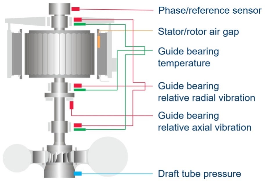

Effective hydropower monitoring requires comprehensive coverage of all critical components, including generating units, turbines, penstocks, spiral cases, draft tubes, and auxiliary equipment. The monitoring strategy must accommodate various turbine types, from Francis and Kaplan to Pelton and bulb configurations, while addressing the specific operational characteristics of each installation.
For smaller hydropower applications, vibration monitoring often provides sufficient diagnostic capability. However, larger units require additional monitoring techniques, including generator airgap analysis, rotor pole magnetic flux measurement, stator insulation partial discharge detection, draft tube pressure monitoring, and comprehensive performance parameter tracking.

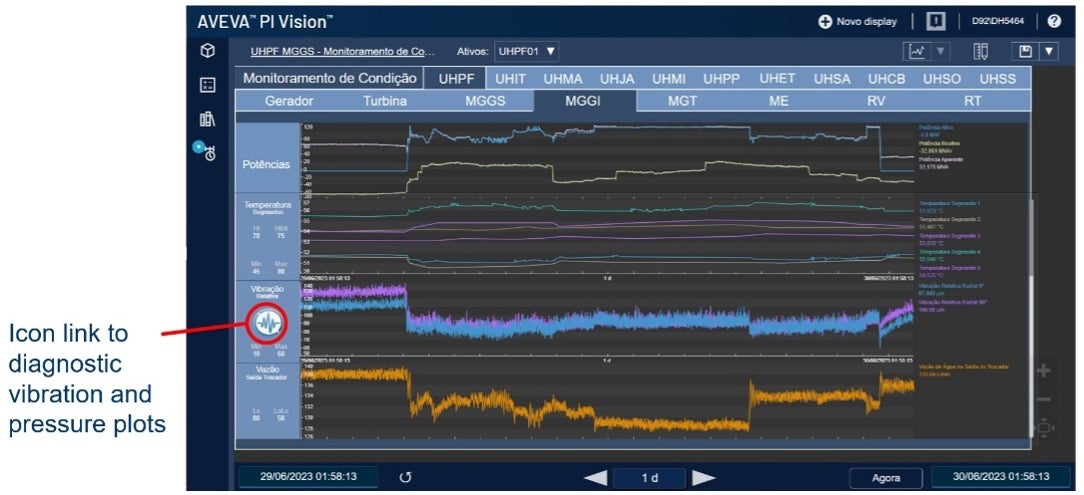

The solution involved integrating condition monitoring and diagnostic capabilities into the existing AVEVA PI System infrastructure (Figure 2), enabling real-time monitoring and data analysis that significantly enhanced operational reliability and maintenance processes. The SETPOINT monitoring system provided native integration with the enterprise historian, delivering comprehensive vibration analysis alongside specialized hydropower monitoring capabilities.
2. AVEVA PI screen showing an overview of the monitoring measurement trends for the lower generator guide bearing of one of the hydro units. Link to SETPOINT plots indicated. Courtesy: B&K Vibro

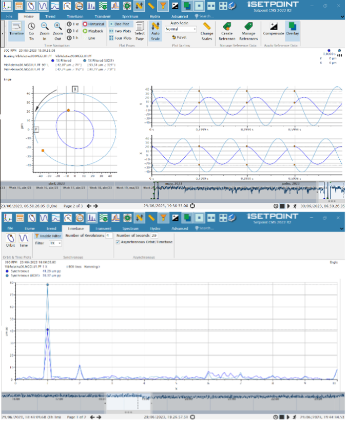

The monitoring strategy accommodated partial-load operations through load-specific alarm limits, enabling power generation across wider operational ranges (Figure 3) while avoiding hydraulic disturbances such as vortex rope turbulence and cavitation. Advanced analytics, including artificial intelligence-driven fault detection algorithms trained on data from nine hydropower stations over eight months, provided early warning capabilities that exceeded traditional monitoring approaches.
3. Plots comparing 80 MW and 110 MW loads for identifying hydraulic imbalance and vortex turbulence. Top, orbit plot of lower generator guide bearing. Bottom, pressure spectrum of draft tube. Courtesy: B&K Vibro
Dynamic pressure monitoring in draft tubes and comprehensive vibration analysis of guide bearings revealed the relationship between hydraulic conditions and mechanical responses across different load levels. These insights enabled operators to optimize performance while maintaining equipment integrity through predictive maintenance interventions.
