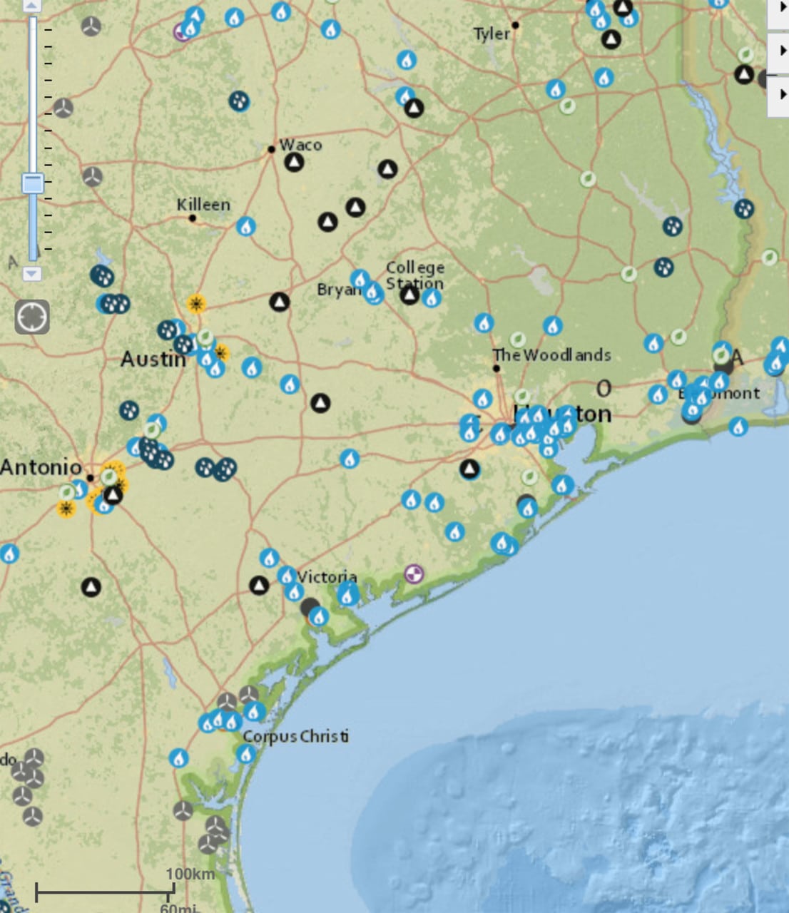

Power plants in Harvey’s direct footprint as of August 25, 2017. Source: https://www.eia.gov/special/disruptions/
ERCOT said it could not provide information on generation resources affected by fuel type, but it may make that information public later.

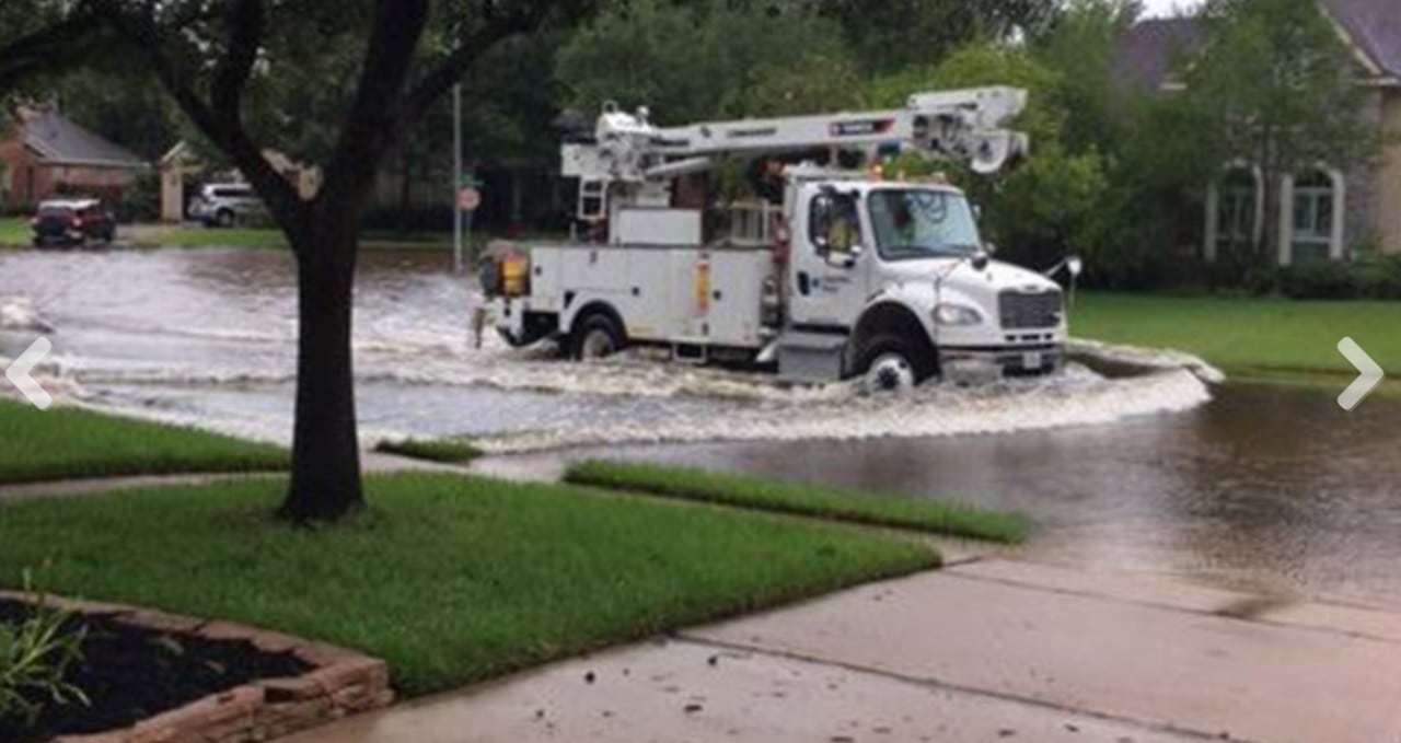

The Edison Electric Institute (EEI), an industry coalition of all the nation’s investor-owned power companies, lauded the power industry’s team effort to restore power in the afflicted region. As of August 30, about 10,000 mutual assistance crew workers (see sidebar, “What Is Mutual Assistance?”) from at least 21 states were assisting impacted power companies with restoration, and additional resources were ready to mobilize further assistance as needed.

“Responding to major events like Harvey requires significant coordination among many public and private sectors. There are interdependencies among the energy, communications, supply chain, transportation, and water and wastewater sectors. Strong industry-government coordination is critical,” noted Brian Reil in a statement on August 30. The power sector, represented by the CEO-led Electricity Subsector Coordinating Council, has had daily calls since August 25 with senior government officials to ensure that all resources can be met, the EEI noted.
