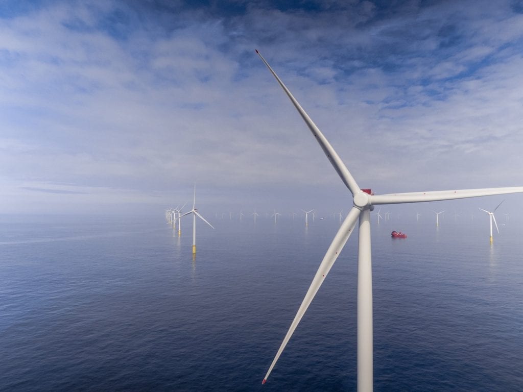

Fluor entered into a contract with Greater Gabbard Offshore Winds Ltd. (GGOWL) to supply the foundations and infrastructure necessary to support 140 wind turbines for the Greater Gabbard Offshore Wind Farm in the North Sea, some 26 kilometers off the coast of Suffolk, England. To ensure the quality of the welds in these massive structures, the contract required that nondestructive testing (NDT) be carried out on the foundation monopiles, which were in turn supplied by Shanghai Zhenhua Heavy Industries Co. Ltd. (ZPMC).
Two different scanning patterns can be used to test for weld quality: Scanning Pattern E (spE) and Scanning Pattern D (spD). The NDT provisions in the contract provided that spD was to be used when welds were ground flush, while spE was to be used when the welds were not ground flush. However, the parties did not appreciate at the time that spD was much more effective in identifying transverse cracks than spE testing, meaning that many of the monopile welds passed inspection when they in fact contained imperfections.
When GGOWL received the first shipment of monopiles, it carried out its own tests on some of them, and transverse cracking was detected. Fluor had to retest all the monopiles in the first shipment and repair any cracks found. Two additional shipments were also tested, and transverse cracking was detected in these as well, forcing Fluor (assisted by ZPMC) to carry out an onerous (and expensive) program of testing and repair for all of the project’s monopoles.
