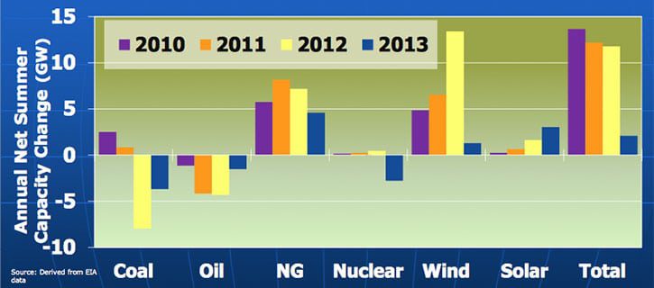

Coal generation, as a percentage of total power output in the U.S., declined steadily to 39% at the end of 2011 from about 51% in 2002, while generation from natural gas–fired combined cycle plants grew to more than 20% from 10% over the same period, the Federal Energy Regulatory Commission (FERC) said on Friday as it released its annual assessment for U.S. energy markets.
The reasons for this are well-known, the State of the Markets Report says: new gas generation is cheaper to build, has shorter construction times, and offers more flexible operations with fewer environmental restrictions. However, coal plant construction "has not come to a halt," notes the report. "Coal still maintains a fuel-cost advantage for large base-load plants in certain locations, particularly where delivered coal costs are low."

Last year saw a marked rush by renewables developers to connect photovoltaic (PV) solar capacity to the grid before the Treasury Department’s cash-grant program expired. About 1.9 GW in new PV capacity was installed, representing a 109% increase from 2010 levels, led by California and New Jersey. At year-end, total capacity reached 4 GW. "In each of the top states, solar investment was encouraged through policies such as solar set-asides in their renewable standards," the report says. "Additionally, photovoltaic construction costs fell 20% last year, after an 18% drop in 2010."
U.S. wind generation capacity grew 6.8 GW, a third of which came online in the Midwest ISO and Southwest Power Pool. Among the new tools to manage the output of variable energy resources more effectively was MISO’s voluntary tariff category, the report notes. "By allowing registered resources to be dispatched economically in real-time, ‘DIR’ provides more efficient curtailment through market software to manage congestion, a common need in Minnesota, Iowa and other parts of MISO’s western region. Previously, wind resources might be manually curtailed as often as three times daily, with the system instructing wind generators to turn off large blocks of production for long periods of time. By December, 19% of MISO’s 10.6 GW of wind had registered as DIR resources."
