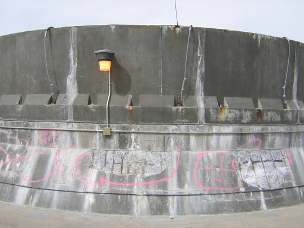

Visual assessment of the lower assemblies determined several items of concern, including the high-temperature environment, minimum concrete cover of ¾ inch, and water seeping down the outer face of the assembly at the joint between the upper precast and lower cast-in-place concrete. Constant contact with steam was causing elevated concrete temperatures and high moisture content. Each of these variables was contributing to the rebar corrosion (Figure 2).
2. Much spalling found. The upper and lower fan stack assembly and the areas requiring repair on one of the four towers is shown. Courtesy: Restruction Corp.

Delamination mapping of the lower assembly concrete determined that, on average, 15% of the 600 square feet for each assembly was delaminated.
Petrographic analysis of the cores revealed poor air entrainment and locally abundant micro-cracks throughout the core body. The concrete was generally of good quality. Carbonation depth was measured at 0.13 inches.
Based on this information, conclusions were drawn regarding the source of corrosion. The effect of high concrete temperatures, high moisture content, and the wetting and drying action at the outside face of the assembly concrete were cause of the corrosion found on the cooling towers.

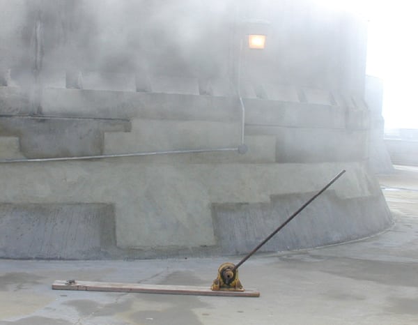

3. Coating tower interior. Coatings were applied in the lower assembly interior after repairs were completed. Courtesy: Restruction Corp.
Access, surface preparation using 20,000-psi water lances, and coating installation would be accomplished during a 30-day plant shutdown.
Access was built using prefabricated wood joist and planks bearing on steel angle assemblies attached to existing structure. Partial removal of the grout joint between the upper and lower assembly to facilitate waterproofing was also completed during the shutdown and would minimize water penetrating through the outer concrete face. The grout was removed to a depth of approximately 2 inches. Open cell backer rod was saturated with urethane multi-grout, activated, and installed in the joint. A polysulfide caulking was installed over the top to provide a finished appearance.
The coating system was installed in two topcoats to minimize pin-holing. A moisture vapor test was completed prior to installation to minimize the chance of debonding. The project was completed in two phases and entailed applying 14,400 square feet of coating inside 24 separate assemblies in each phase.

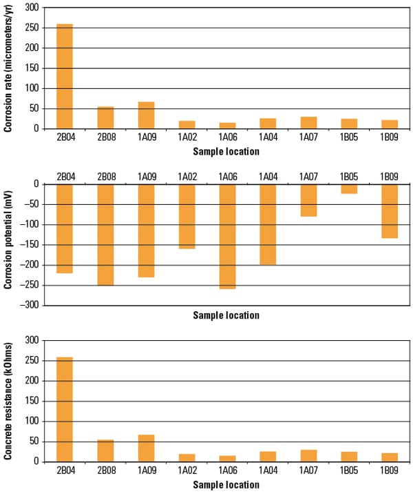

As the first repair construction phase of the project was nearing completion in 2005, the plant engineering team raised the question of how to measure the repair program’s success. Quickly, a plan was implemented to measure corrosion. Luckily, the second phase, Unit 2 project was still in the active corrosion mode. Unit 1, consisting of 24 assemblies in the first phase, was repaired and the reinforcing steel repassivated.
The corrosion measurement plan was to measure corrosion current, corrosion potential, and concrete resistance at two fan stack locations on Unit 2. These locations would be considered pre-repair and serve as the baseline. Corrosion rates and potentials were not taken during the investigation phase. It was apparent that corrosion was occurring and the source of initiation was the high concrete temperatures and moisture levels. Furthermore, no future monitoring of the corrosion was planned during the investigation phase.
Measuring corrosion rate, potential, and concrete resistance at seven locations on Unit 1 would serve as the immediate post-repair condition and provide a comparison to pre-repair condition measured at Unit 2.
A Galvapulse corrosion rate meter was used to record approximately 12 readings per assembly. The results are illustrated in Figure 5. An immediate concrete resistance effect was measured. All seven Unit 1 assemblies measured post-repair had higher concrete resistance than the two Unit 2 pre-repair assemblies. On average, resistance increased 135%.
5. Pre- and post-repair data. Data labeled “2B” are pre-repair values. Data labeled “1A” and “1B” are immediate post-repair values. No data signifies that readings weren’t taken at that location. Source: Restruction Corp.
Corrosion rate measured in micro-meters per year also showed immediate improvement. Six of seven post-repaired corrosion rates were below both pre-repaired rates. On average, corrosion rate was reduced 80%.
Corrosion potential showed immediate improvement as well. Adjusted for the silver/silver chloride half-cell, copper sulfate electrode readings in the pre-repair were –315mV CSE and –360 mV CSE (CSE or a copper sulfate electrode is used as the baseline). The average post-repair potential was measured at –270 mV CSE. ASTM Standard indicates that for potentials between –200 mV and –350 mV CSE, corrosion is “uncertain.” Readings more positive than –200 mV indicate with 90% confidence that no corrosion activity is present.

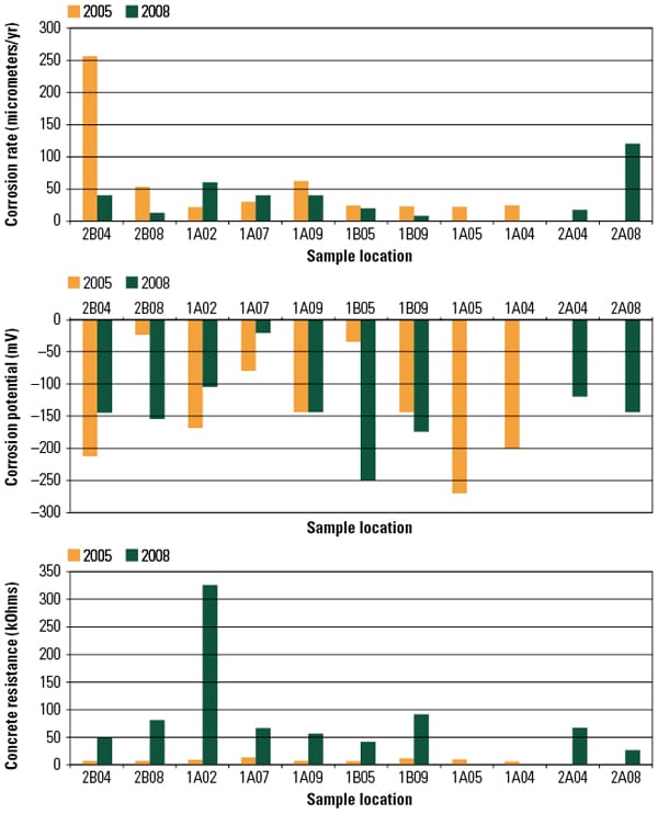

The plant engineering team budgeted additional funds for repair of Unit 2 assemblies to be completed in spring/summer 2008. Three years had passed since completion of Unit 1 repairs. Again, corrosion measurements were taken upon completion. The same two locations on Unit 2 were measured, providing a direct comparison of pre-repair (year 2005) and post-repair readings. Five of the original seven assemblies at Unit 1 were remeasured. This provided a comparison of immediate post-repair and repair-plus-three-years’-time readings. Two new locations at both Unit 1 and Unit 2 were also recorded. Results still indicated that the reinforcing steel was passive, as shown in Figure 6.
6. Follow-up test data. Corrosion data collected three years after repairs were made on each set of cooling towers found that the corrosion rates were significantly reduced from the as-found condition. Source: Restruction Corp.
Concrete resistance increased in both Unit 2 post-repair measurements and Unit 1 measurements recorded in 2008 versus 2005. Average concrete resistance increased over the three-year operation period. Unit 1 resistance increased from 49 kilo-ohms immediate post-repair to 115 kilo-ohms measured three years later.
A U.S. standard has not been developed for corrosion current. However, a proposed Norwegian standard indicates values of 11.5 to 58.0 micro-meters per year would be considered low corrosion. Less than 11.5 micro-meters per year indicates negligible corrosion. The Norwegian standard converts corrosion rate units of micro-amps per centimeters squared to cross-section loss of reinforcing steel using Faraday’s Law.
A low corrosion rate (11.5 to 58.0 micro-meters per year) was found in Unit 1 immediate post-repair measurement in 2005, and the 2008 measurement showed low to negligible corrosion activity. The rebar in Unit 1 remains passive due to the implemented repair scheme. Unit 2 assemblies that were measured prior to repair in 2005 and then again post-repair in 2008 recorded improved corrosion currents in the low to moderate corrosion activity levels.
The corrosion current levels have dropped significantly. Corrosion potentials are also expected to continue improving as the rebar becomes more passive. These results demonstrate that the repairs started in 2000 and completed in 2008 were successful and the towers’ concrete will remain serviceable for many years to come.
