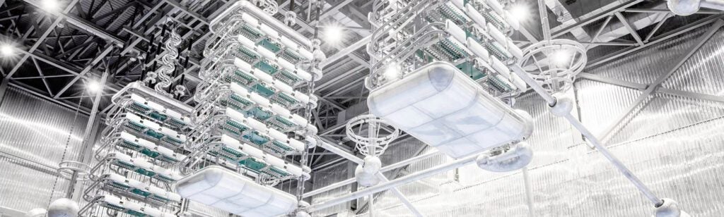

Konverterhalle einer Stromrichterstation der HGÜ-Verbindung zwischen Frankreich und Spanien: HVDC-Plus-IGBT-Stromrichtermodule für 1000 MW. Converter hall of a converter station of the HVDC transmission link between France and Spain: HVDC Plus IGBT converter modules for 1000 MW.
3. HVDC converter station. The converter hall shown here is part of an HVDC transmission link between France and Spain. It utilizes Siemens’ HVDC Plus insulated-gate bipolar transistor converter modules to supply capacity of 1,000 MW with voltage of 320 kV, which is currently the most powerful link in the world, using voltage source converter technology. Courtesy: Siemens
